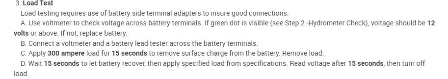

It sounds like your battery is low or dead. You need to test the voltage at the battery. It needs to be 12.4 to 12.6 volts for all the systems to come alive.

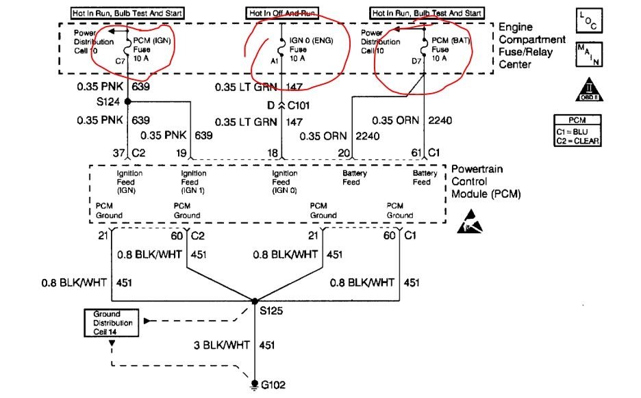

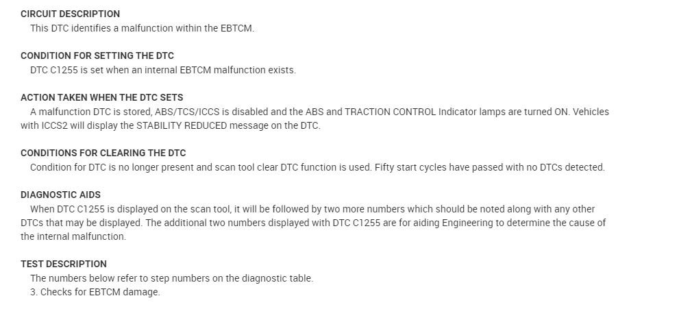

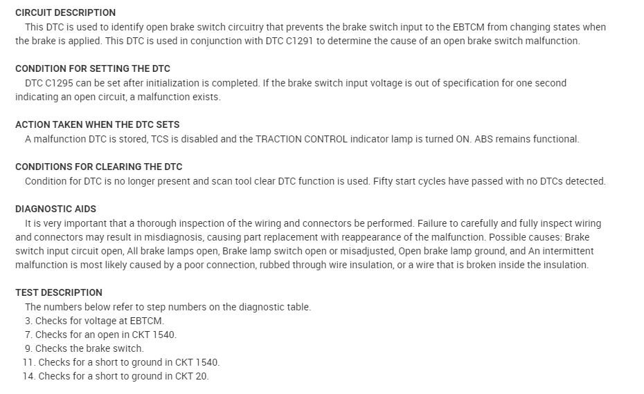

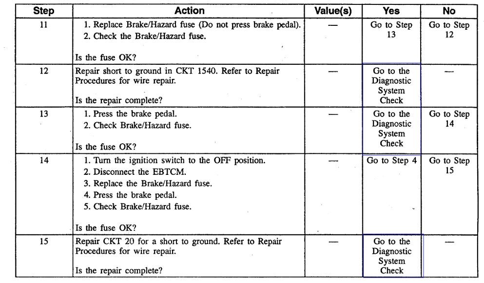

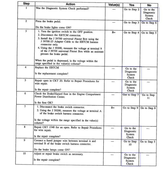

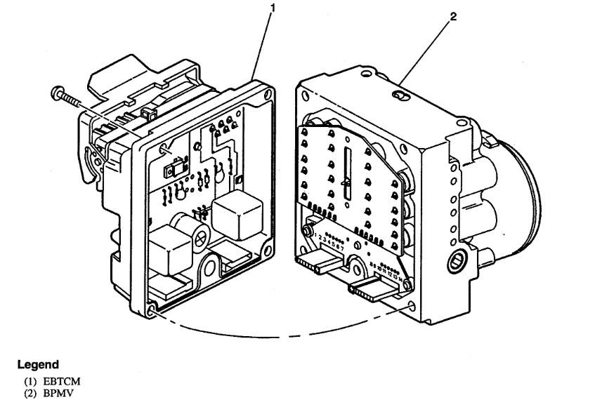

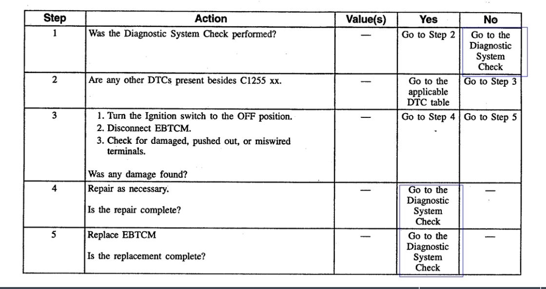

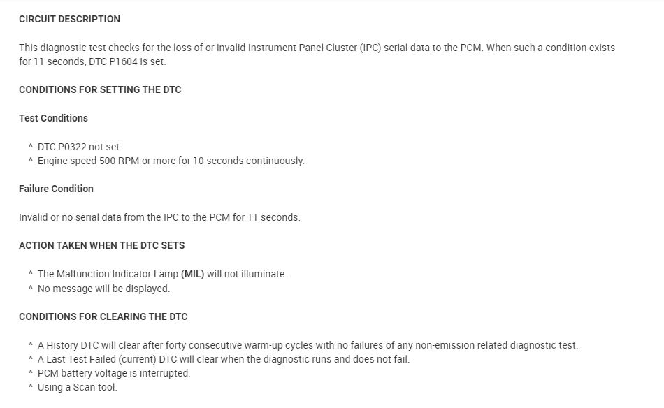

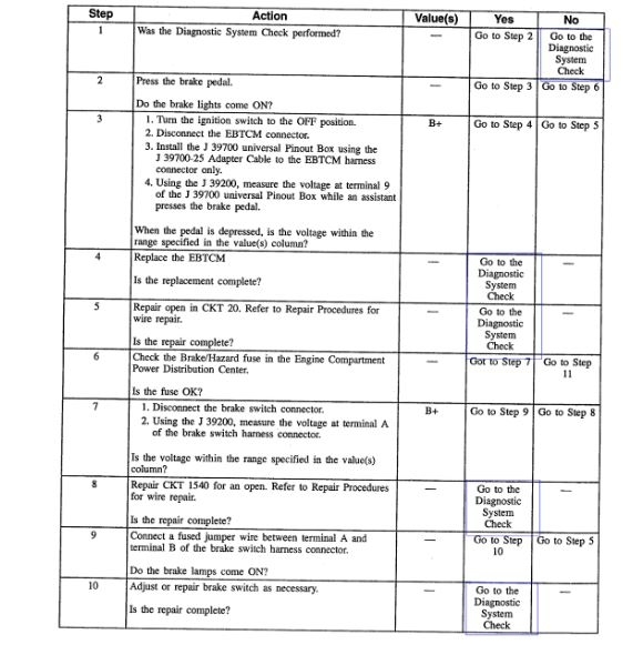

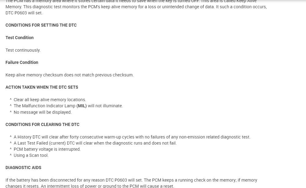

As far as the codes, I attached possible issues for the codes.
The C codes are ABS related. It is a possible bad control module but needs to be confirmed.

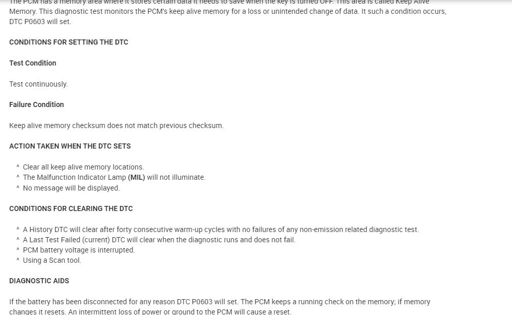

The 603 is for the ECM. Powers need to be verified to be sure there is not a lack of power.
The first thing that needs to be done is the battery. Make sure the battery is good. It could be the battery not able to supply correct power for the modules.
