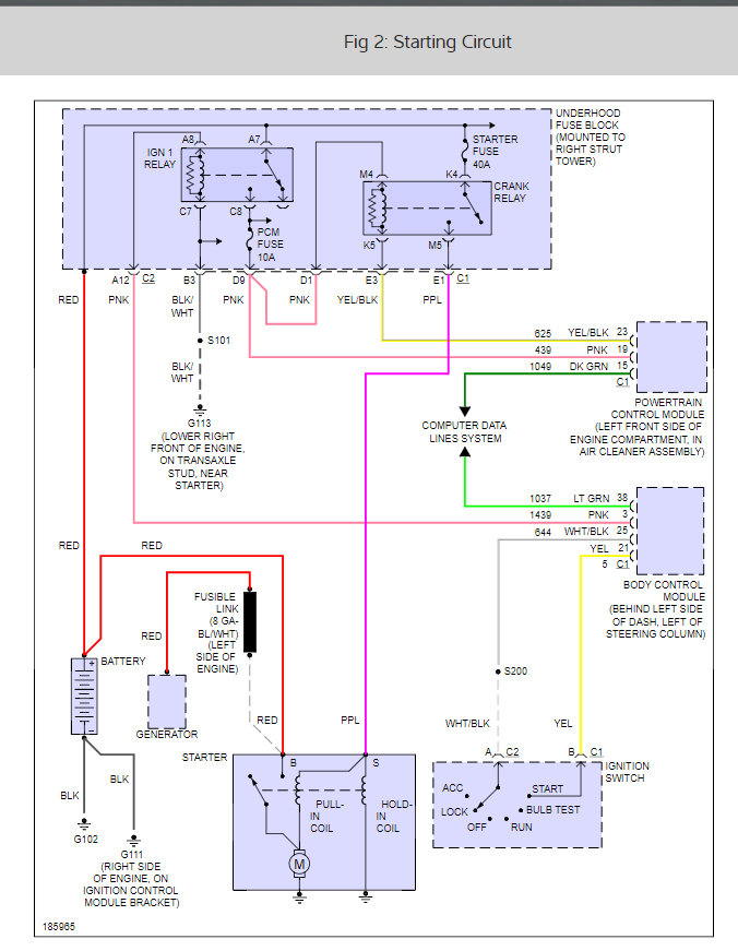

Replaced starter on my daughter's 2004 Pontiac Grand Prix GTP. Now, car will not start and the DIC gives message "starter disabled by theft system". I have tried disconnecting battery and several other suggestions to turn car off and on waiting for security system to turn off, but they did not work. I went to three different auto parts stores, none of them had a code reader/scanner that could clear the problem.
Nov 1, 2018 at 11:40 AM (Merged)
It sounds like you got the wiring wrong on the starter. Did you get the trigger wire on the right lug becasue there are two positions and only one will work.
Here is a wiring diagram for you. (below)
Also to reset the alarm you need to remove the negative cable and touch it to the positive cable for 5 minutes, this will hard reboot the system.
