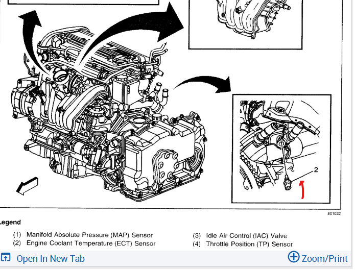

Here is the location of the coolant sensor. Check out the images (below). Let us know how it goes.
