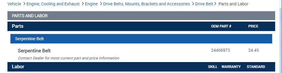

Unfortunately they don't list an option with non A/C. This means you have three options. First, you can try and call the dealer and see if they have a listing for a non A/C option however, I suspect they will not either.

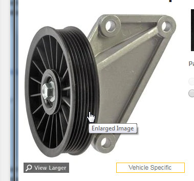

Second, you can get a bypass pulley and remove the compressor and install this in its place, then you can use your existing belt.

Again, due to it not having listing, we wouldn't know the size of the belt without measuring it ourselves. Let me know if you have questions. Thanks
