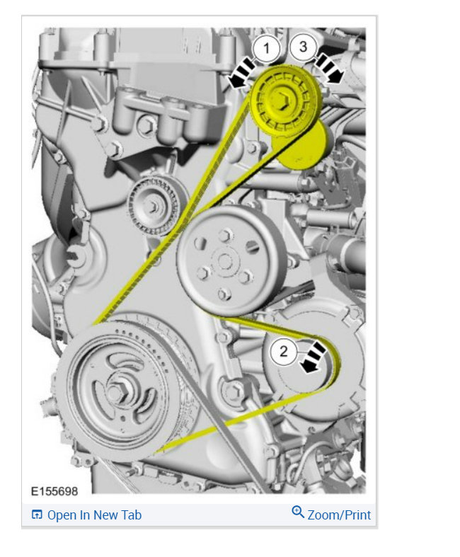

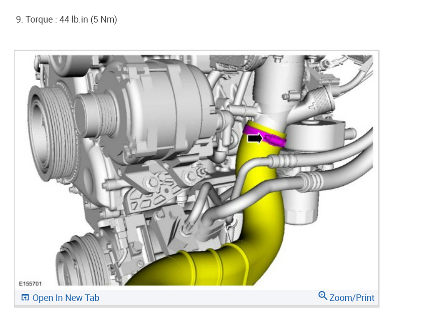

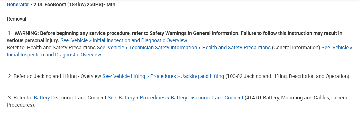

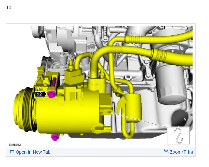

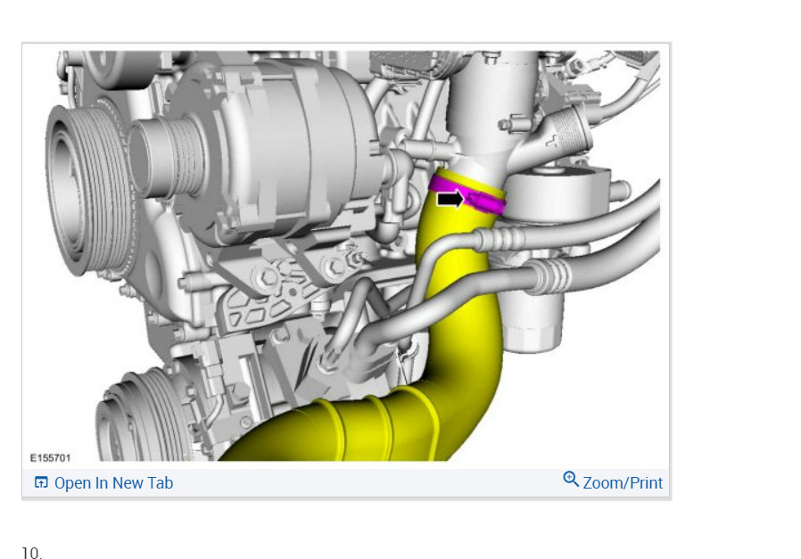

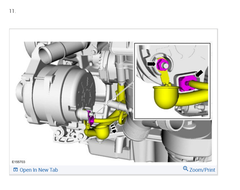

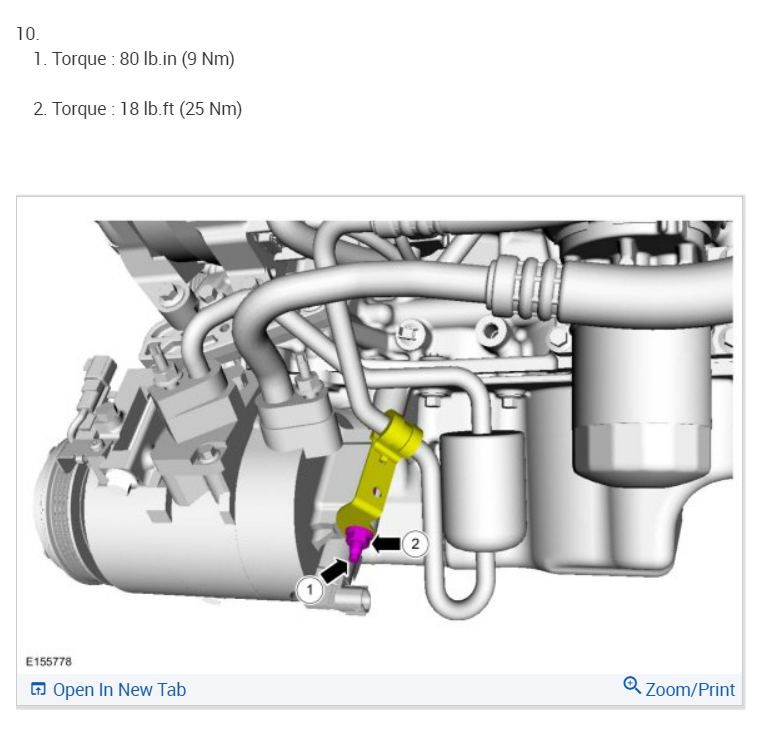

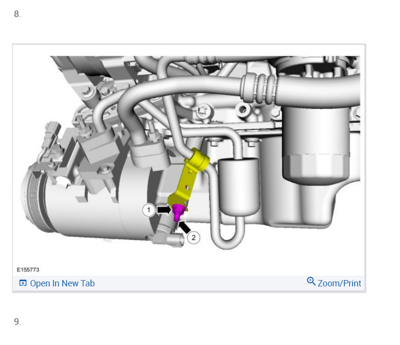

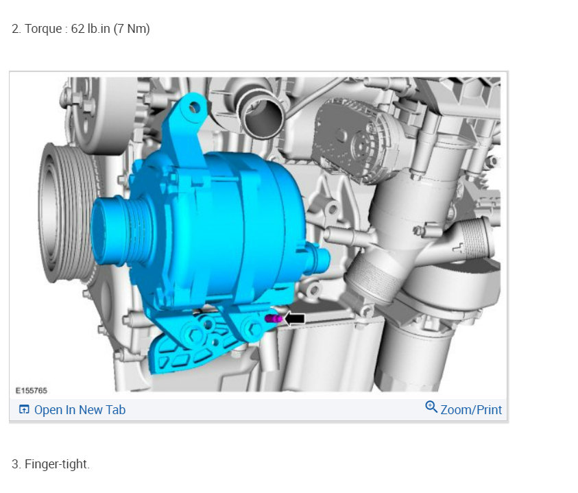

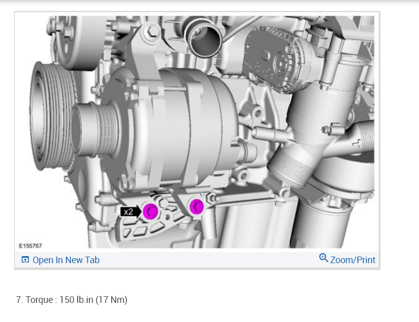

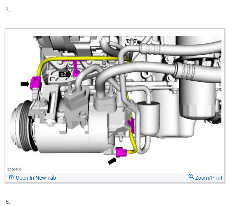

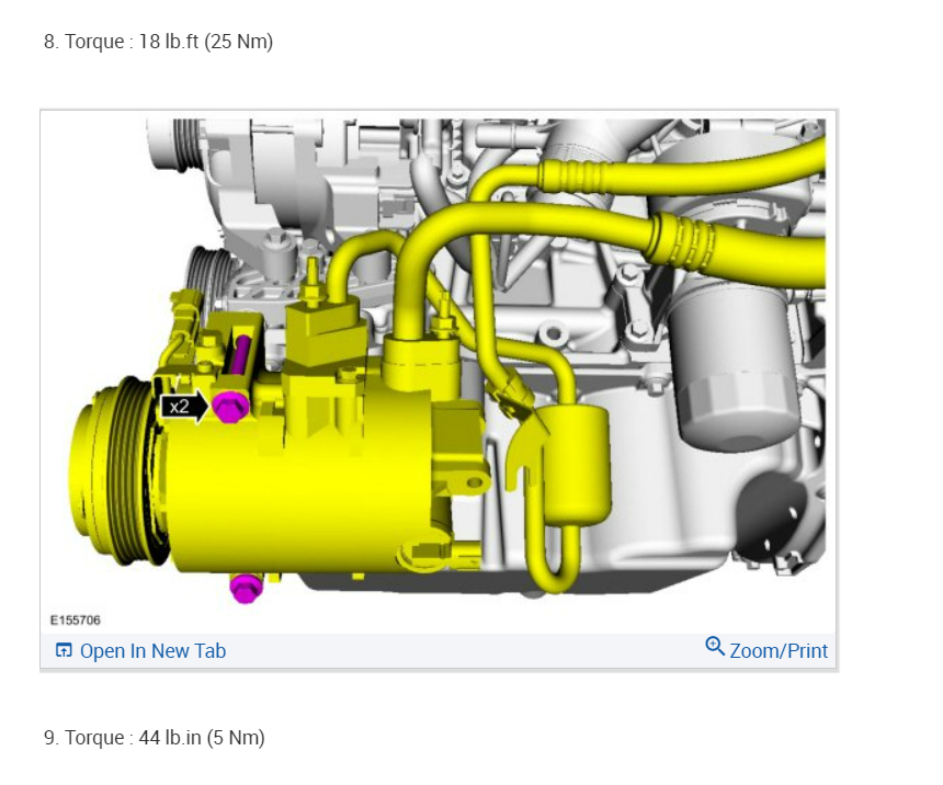

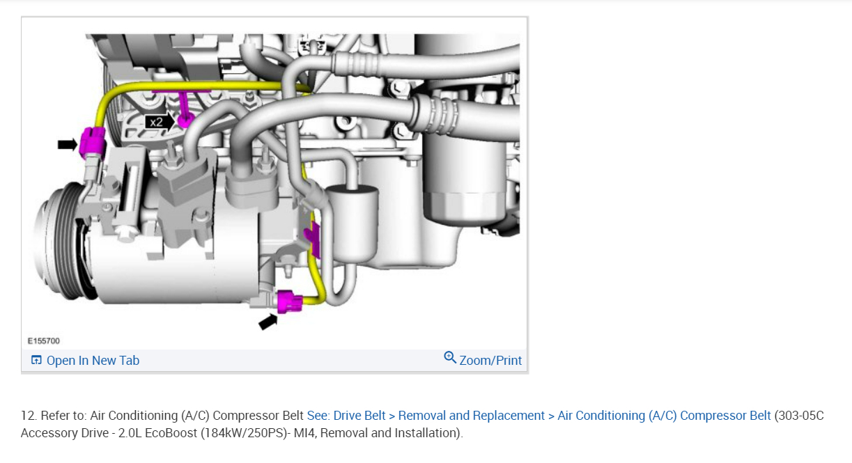

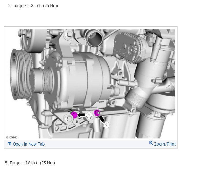

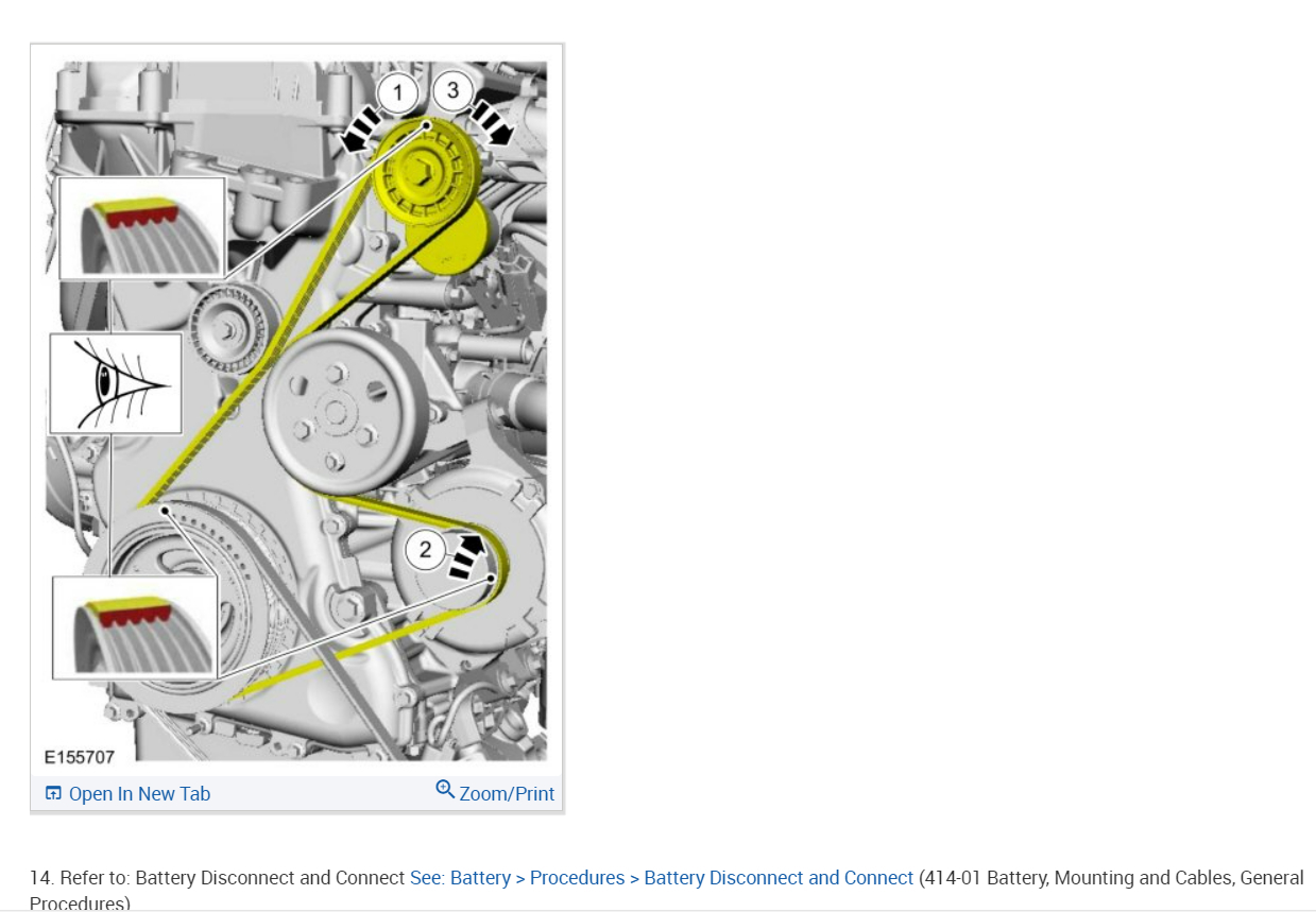

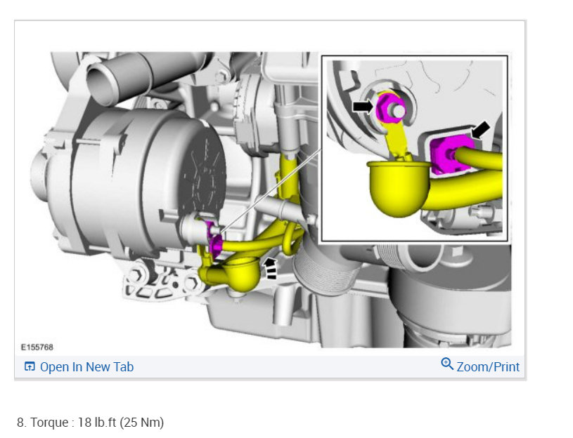

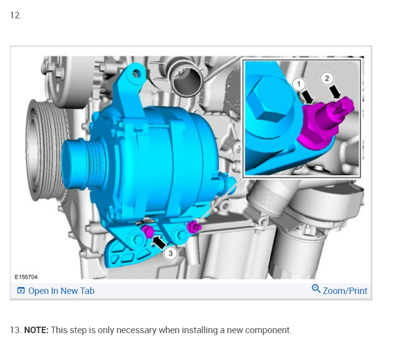

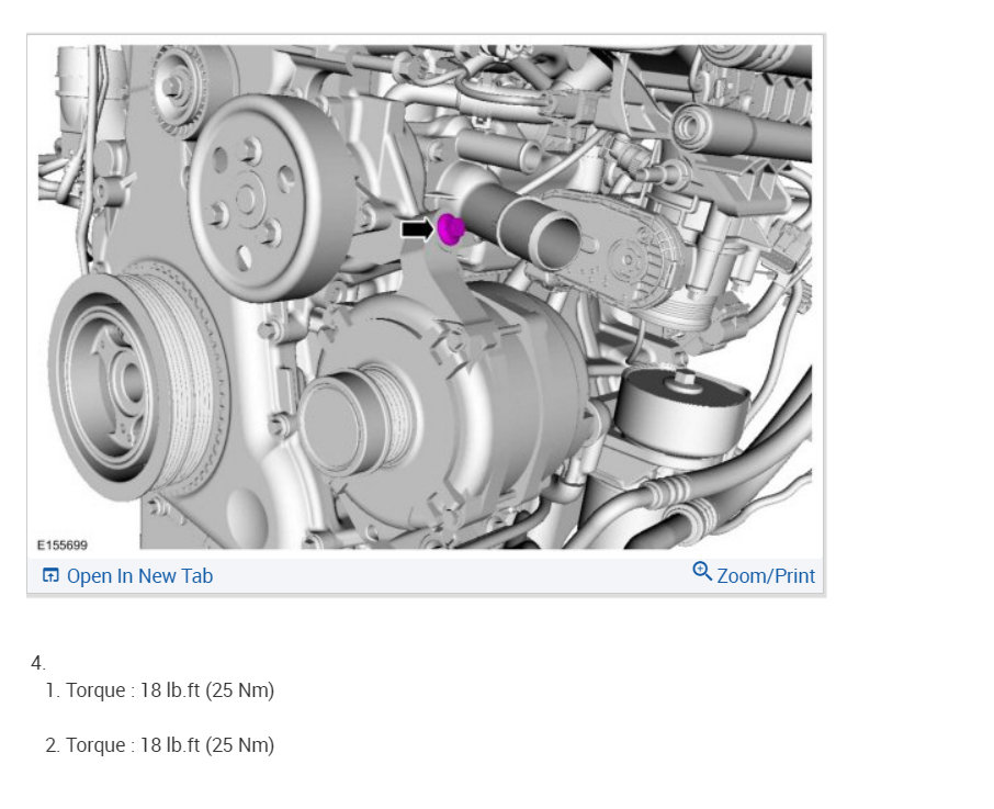

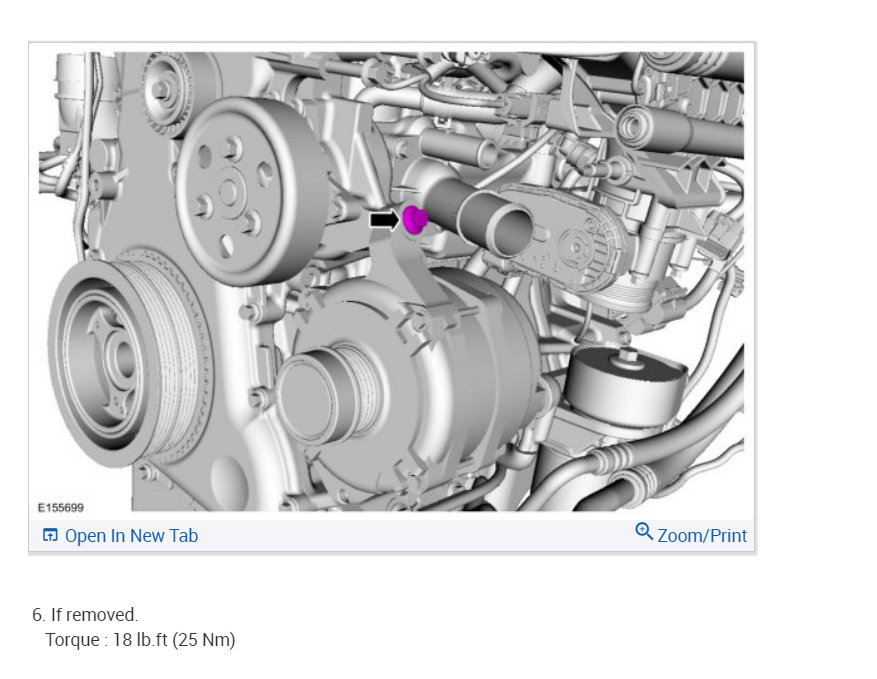

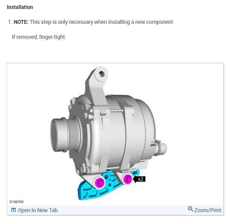

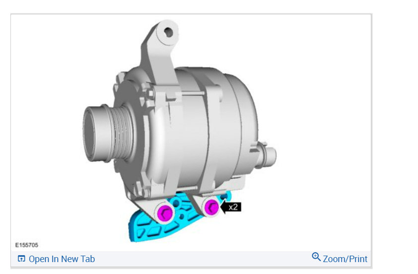

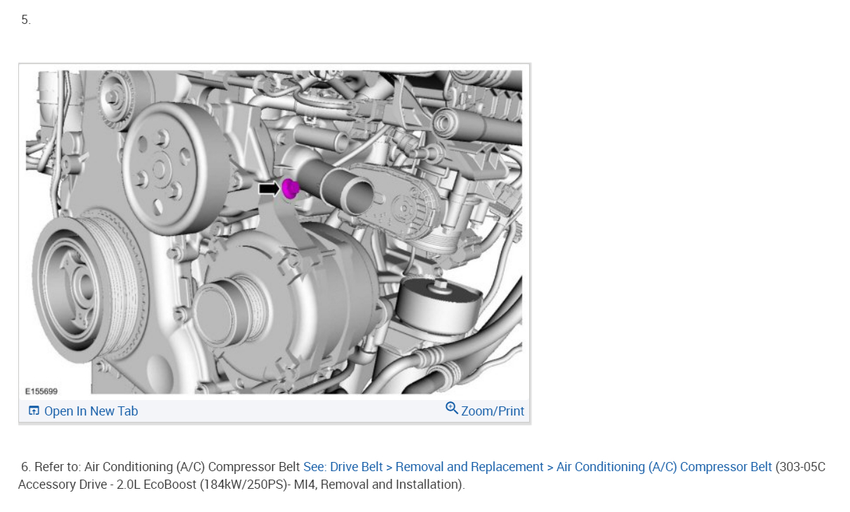

Here are the specs on the alternator which will vary depending on the accessories your car has, I also included how to change the alternator out in the diagrams below.
Alternator
1 - Without Heated Seats
DS7Z10346T
498.18
With Heated Seats
1 - With Power Point Plug
G2GZ10346J
621.82
1 - With Power Point Plug L2
HU2Z10V346CJRM
620.00
1 - Without Power Point Plug
DS7Z10346T
498.18
Also included instructions on how to change the unit out. Check out the diagrams (below). Please let us know if you need anything else to get the problem fixed.
