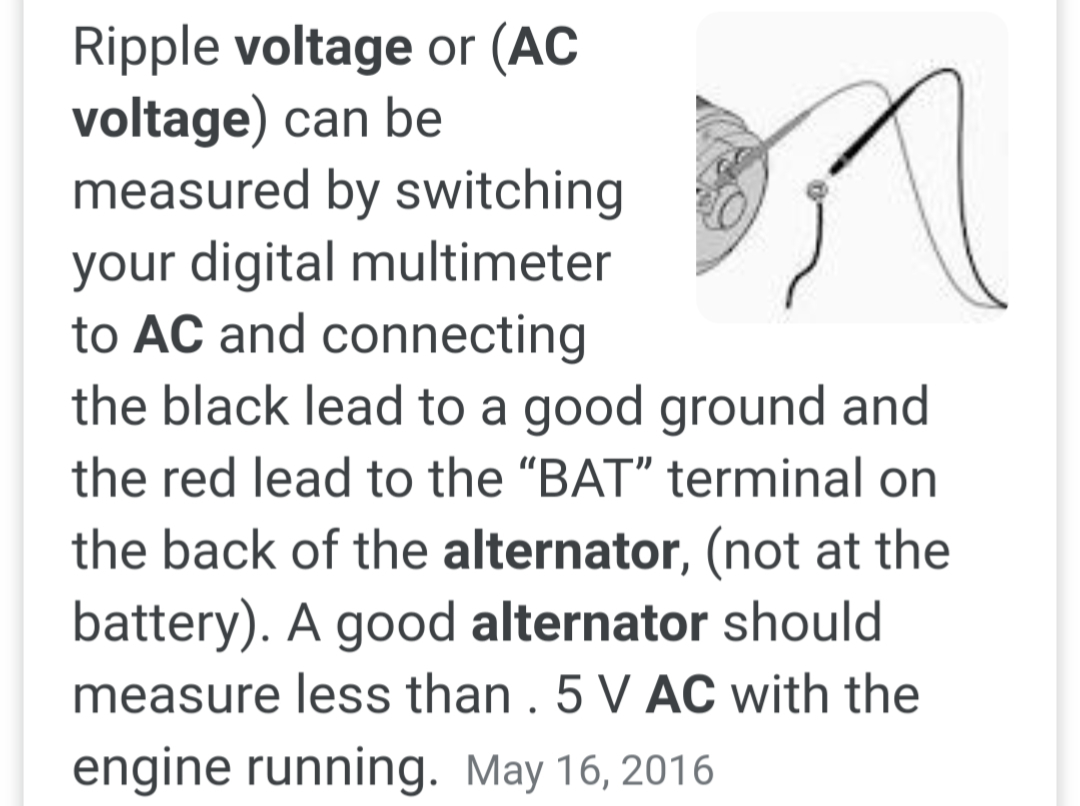

Hello, just to add a thought. I've seen a bad speed sensor cause the speedometer issue, and also check the alternator for any ac voltage coming out, bad diodes in the alternator will cause ac voltage to ripple through the system and the vehicle's ECM will go wacky. Here's the test for ac voltage. Just to verify the alternator isn't at fault.

I thought about the speed sensor as well, and some people even told me about the transmission solenoid. As for the alternator it's a brand new one that I put in a year ago.

We're glad to help, the alternator putting out ac voltage can do weird things. I always check them first in a situation like this. Voltage level correct and no ac ripple coming from it.
