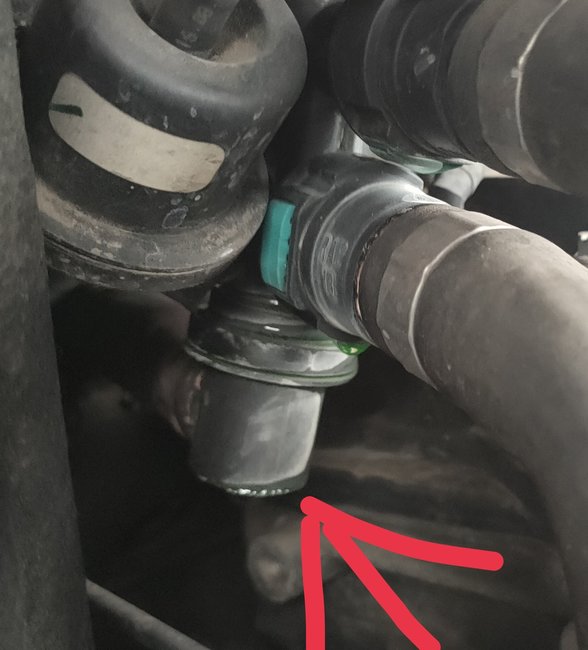

Hi, I need to know what part it is so I can buy it online and replace it myself. it is leaking coolant fluid. please see image. thank you

This is the internal heater outlet hose connection, part number 1371567
