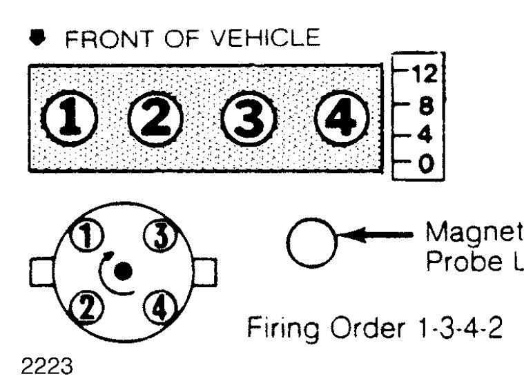

My name is Richard I bought some spark plug wires yesterday that were the wrong engine size. I have a 2.5 liter and I totally without thinking took the spark plug wires off put the ones that I had originally got which was for a 2.2 liter and I need help getting them back in order.

we can't tell you which length you need you'll need to figure that your self pic will show firing order. you can always return the wires for the correct set also long as you have the box and reciept

I needed the firing order and spark plug wire layout please

Check out the image above, 1 goes to cylinder 1 and so on.
