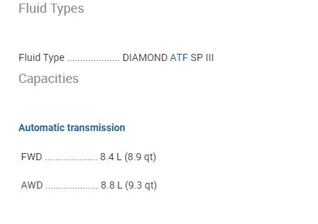

What kind of transmission fluid am i suppose to use
2006 MITSUBISHI ENDEAVOR
500,000 MILES • 4WD • AUTOMATIC
BABYEZE29
I dont know what exact transmission i am suppose to use for my car.
Feb 5, 2020 at 6:34 PM
Good evening,

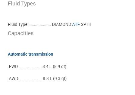

I attached the fluid type and fluid capacity for you. Check out the diagrams (Below). Please let us know if you need anything else to get the problem fixed.
