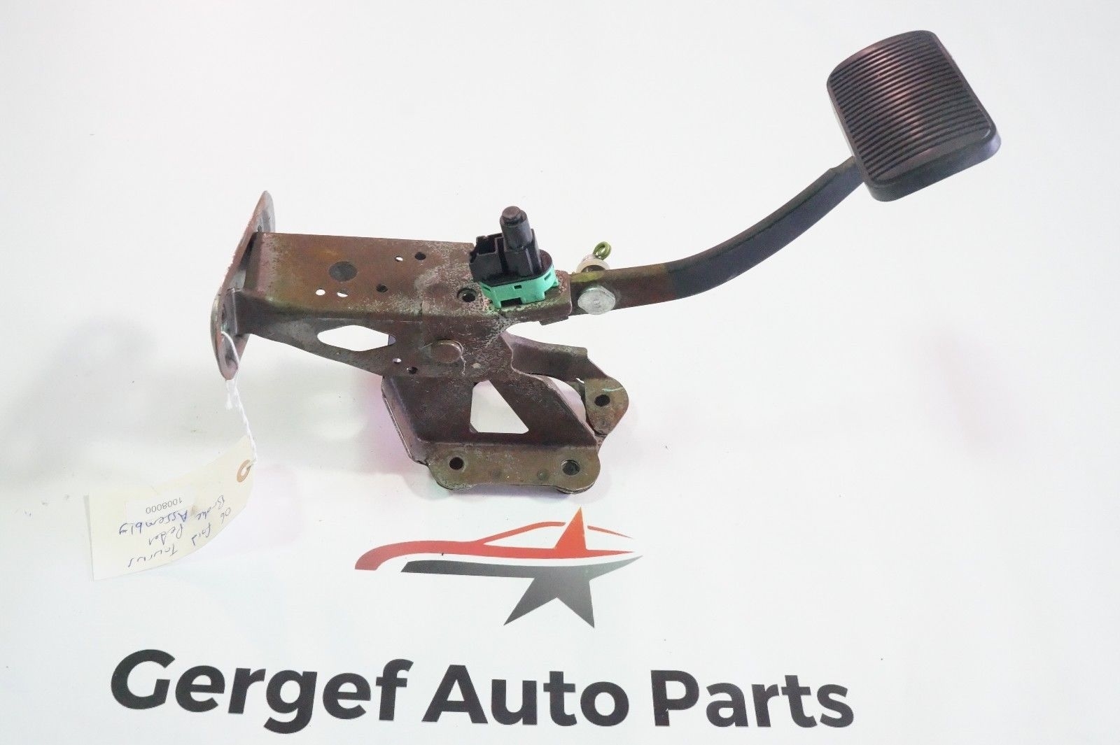

Sorry for the super late response. I still have this issue with the brake pedal. Really loud groaning noise when slowly releasing, I have the sprayed the metal joints and entire assembly with chain lubricant and also white lithium grease. I found a pedal assembly on eBay but I just wanted to show you the picture to find out what specific parts I need to lubricate. If I did not mention it before, probably five months ago I replaced the front disc, pads and calipers and the rear drum brakes were completely replaced at Firestone a little over a year ago. I have had the issue for over a year now.

STEVE W.

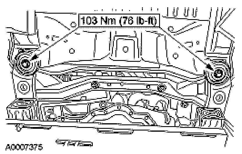

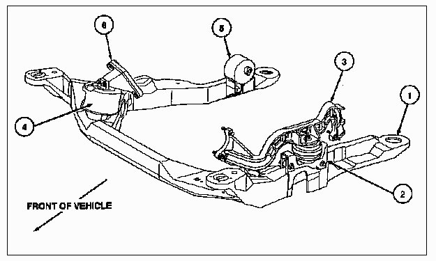

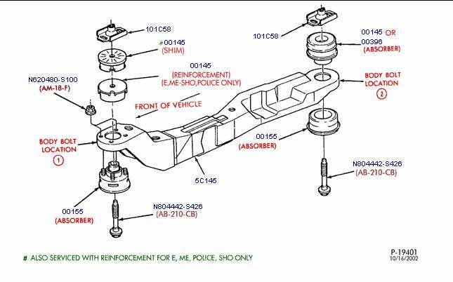

Ken, that was my first thought, had him lube the pivots, still noisy. However, if you can hear it outside the car and feel it as well I would look at the sub-frame mounts where they bolt to the rest of the chassis. It could be the bushings are shot and the groaning is the sub-frame shifting in relation to the rest of the chassis as the car moves.
Sep 8, 2018 at 6:24 PM
JGONZO2398
  • 372 POSTS
Subframe mounts, where are those?
Sep 8, 2018 at 7:15 PM
STEVE W.
  • 15,113 POSTS
Under the car. There are four bolts that retain the front sub-frame to the chassis. Two in front two toward the rear. The sub-frame holds the engine and transmission in the car. What you are hearing could be those mounts creaking a bit as they are loaded and unloaded by the vehicles motion. When you step on and off the brakes the engine and transmission transfer power through those mounts to move the vehicle. If the bushings are worn and move even a small bit they could creak. There are kits out there to replace them. The two rear ones are the most failure prone and one sets just about directly under the drivers foot well. However, while they are replaceable you might be better off just spraying them with some silicone lube to see if you can quiet them. They are not really difficult to replace but if things are rusty they can become an issue.
