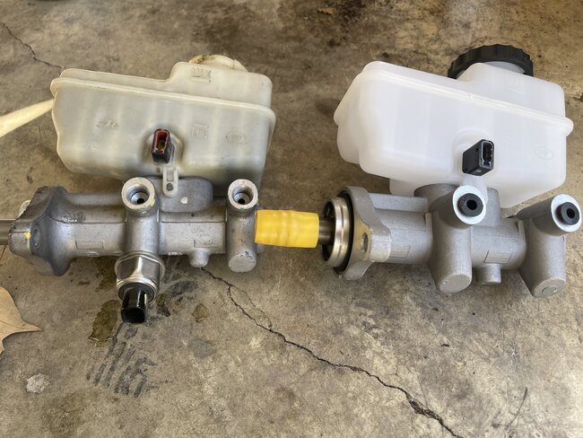

What is this connector under brake master cylinder?

New one didn't even come with a hole for it.

Got a picture? It could be the front pressure sensor for the ABS. Post a pic and the wire colors please.

Oh forgot to attach it. On bottom.
I ordered the right one but just wanted to know what it is.

Yep, that is the front pressure sensor for the ABS system. Your replacement is for a vehicle without ABS on it.
