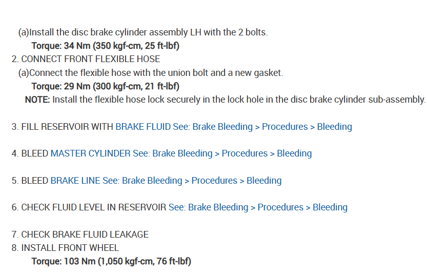

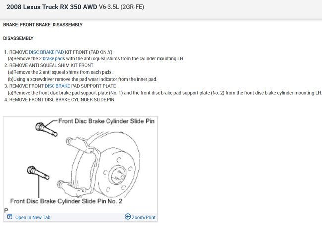

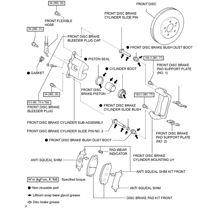

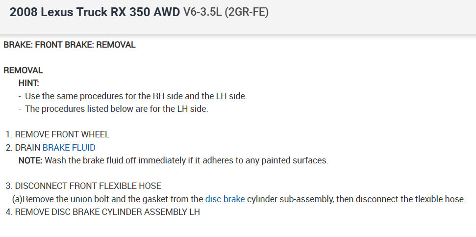

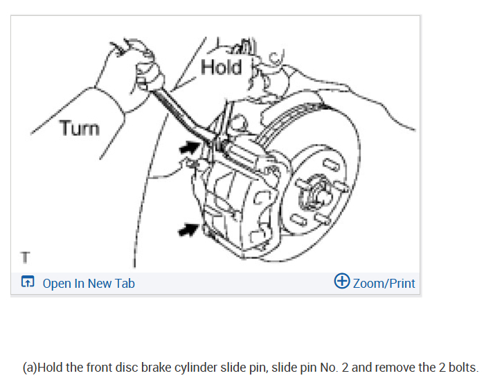

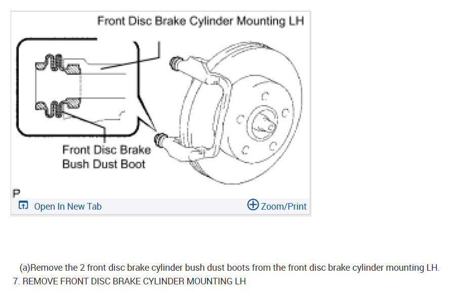

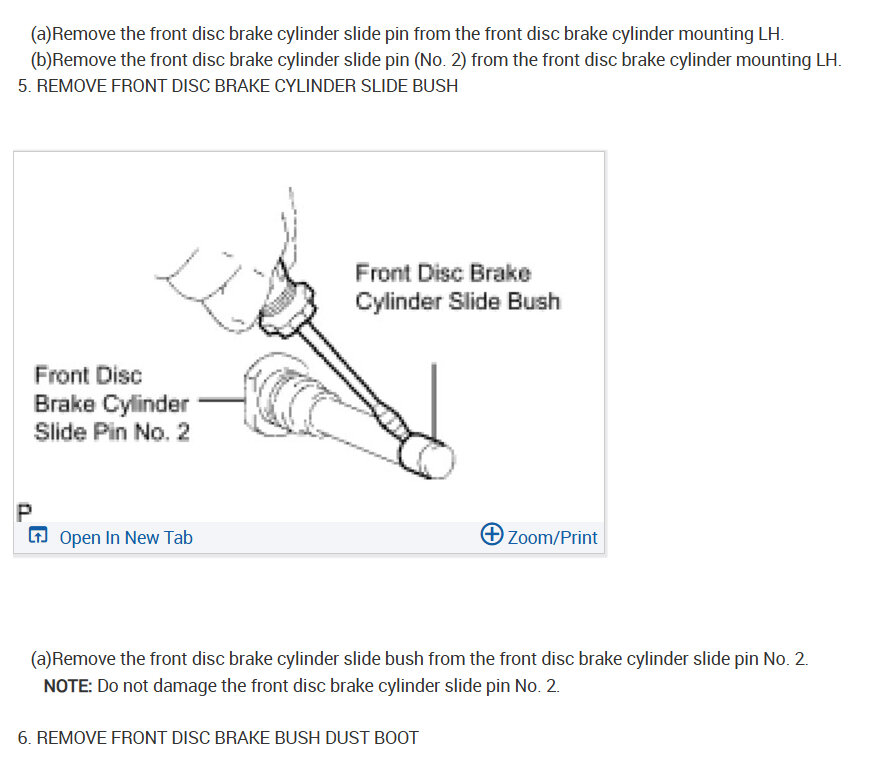

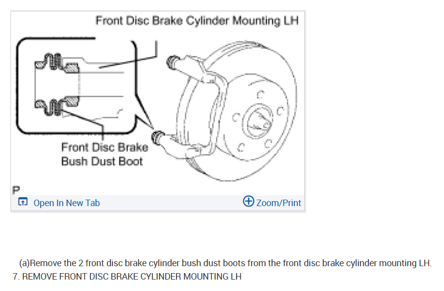

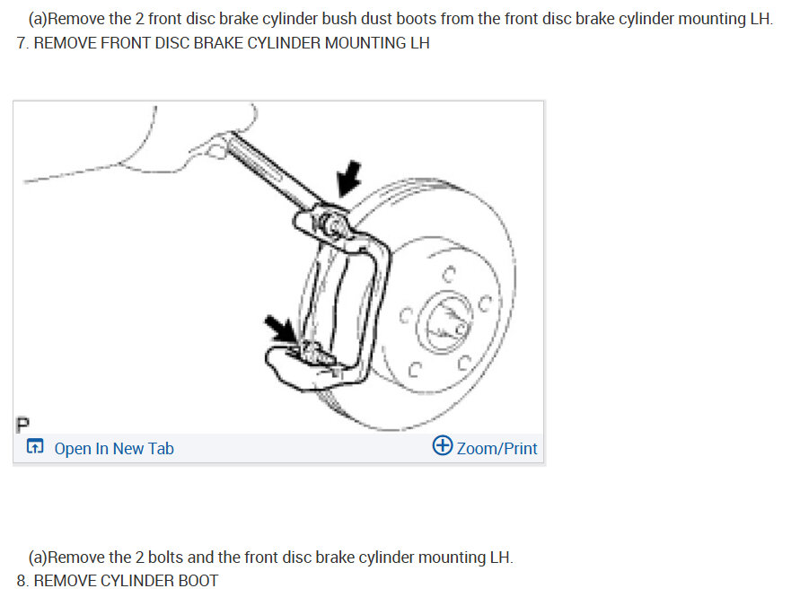

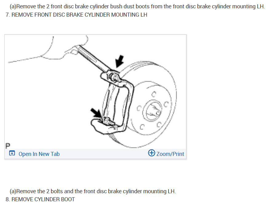

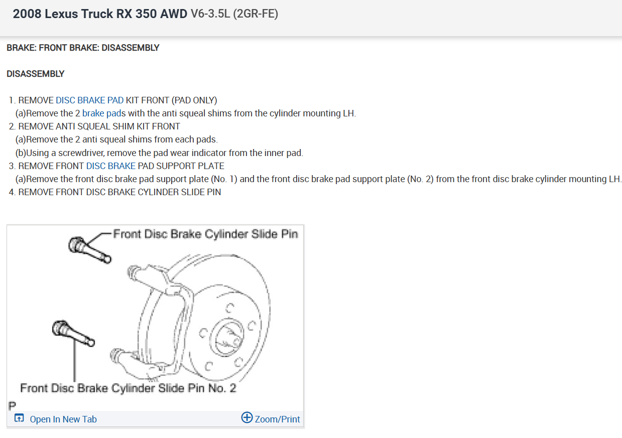

The front is not that much different than the rear. We use brake grease with you can get at the auto parts store or amazon. Here is how the brake job is done with the torque specs to help you get the job done. Here is the video in question:
https://www.youtube.com/watch?v=k1huwZpe-Qg&t
Check out the images (below). Please upload pictures or videos in your response of any problems so we can see what to help you with.
