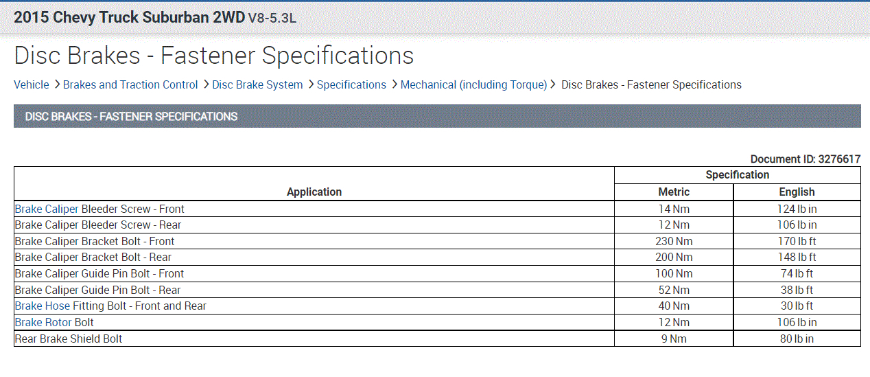

what is the torque on rear caliper bracket bolts
2015 CHEVROLET SUBURBAN
130,000 MILES
SALMINEO SALINAS
Can't find the torque sequence please I need to do the rear brakes please?
Jun 28, 2019 at 2:27 PM
As far as a torque sequence, there are only two bolts to worry about. I always will start both, snug one, and then tighten the other to spec. Then, I tighten the one I snugged to specification.
As far as the torque specifications, I attached them below. The list contains all fastener torque specifications for both the front and rear brakes.

See pic below.
