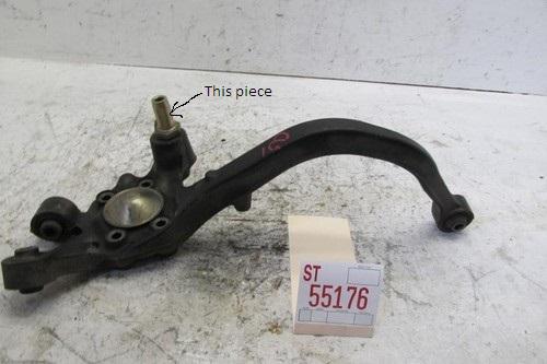

What is the name of the bolt that is attach to the knuckle on the pic I uploaded?

I need to replace the bolt that is attached to the knuckle (See uploaded photos). I don't know the name. It's a piece where you can insert the end of the strut and connects it using a strut bolt mount at the other side of this piece.

is this the rear knuckle?

to me it looks like the right rear knuckle, and the bolt your describing is the rear shock mount....

I took the old bolt into the mitsubishi dealer because I can't find them in any auto parts store. They told me that, "I can't buy the shock mount itself." They also said, "I have to buy the whole knuckle to get the parts." I'm not sure if there lying and trying to make more money out of me. What is your intake on that?

i would believe them... however, there is a cheaper alternative... find a good used knuckle from a junkyard.... you will save a bunch of money, and get the last laugh.
