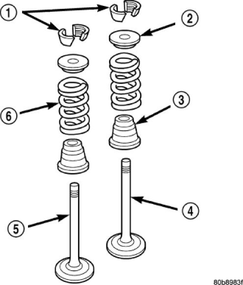

Most likely the cause is bad valve seals. I attached a picture below. If you locate number 3 in picture 1, it is the seal that I am referring to. Now, each valve stem has one. To check them requires removal of the valve covers so you can see them.
To replace the seals, the valve springs need removed. There are different ways of doing it, but the flat rate (labor time) calls for 6.6 hours to do both sides which doesn't include parts.

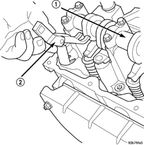

Picture 2
1. Remove the cylinder head cover See: Valve Cover > Removal and Replacement > Cylinder Head Cover - Removal .
2. Using Valve Spring Compressor 10102 (2), remove the rocker arms and the hydraulic lash adjusters.
3. Remove the spark plug for the cylinder the valve spring and seal are to be removed from.
4. Apply shop air to the cylinder to hold the valves in place when the spring is removed
NOTE: All eight valve springs and seals are removed in the same manner; this procedure only covers one valve seal and valve spring.
5. Using Valve Spring Compressor 10102, compress the valve spring.
NOTE: It may be necessary to tap the top of the valve spring to loosen the spring retainers locks enough to be removed.
6. Remove the two spring retainer lock halves.
NOTE: the valve spring is under tension use care when releasing the valve spring compressor.
7. Remove the valve spring compressor.
8. Remove the spring retainer, and the spring.
9. Remove the valve stem seal.

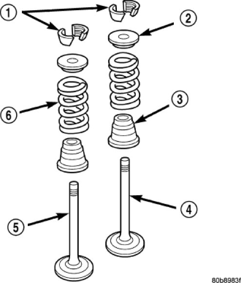

Picture 3
1. Coat the valve stem with clean engine oil and install the valve stem seal. Make sure the seal is fully seated and that the garter spring at the top of the seal is intact.
2. Install the spring (6) and the spring retainer (2).
3. Using Valve Spring Compressor 10102, compress the spring and install the two valve spring retainer halves.
4. Release the valve spring compressor and make sure the two spring retainer halves and the spring retainer are fully seated.
5. Position the hydraulic lash adjusters and rocker arms.
6. Install the cylinder head cover See: Valve Cover > Removal and Replacement > Cylinder Head Cover - Installation .
7. Install spark plugs and plug wires.
Let me know if this helps or if you have other questions. Please keep in mind, this is a theory at this point, but I feel confident that is the problem.
