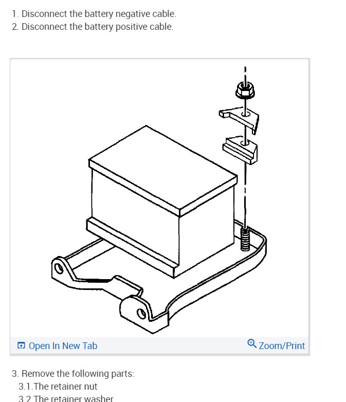

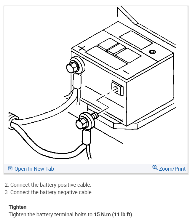

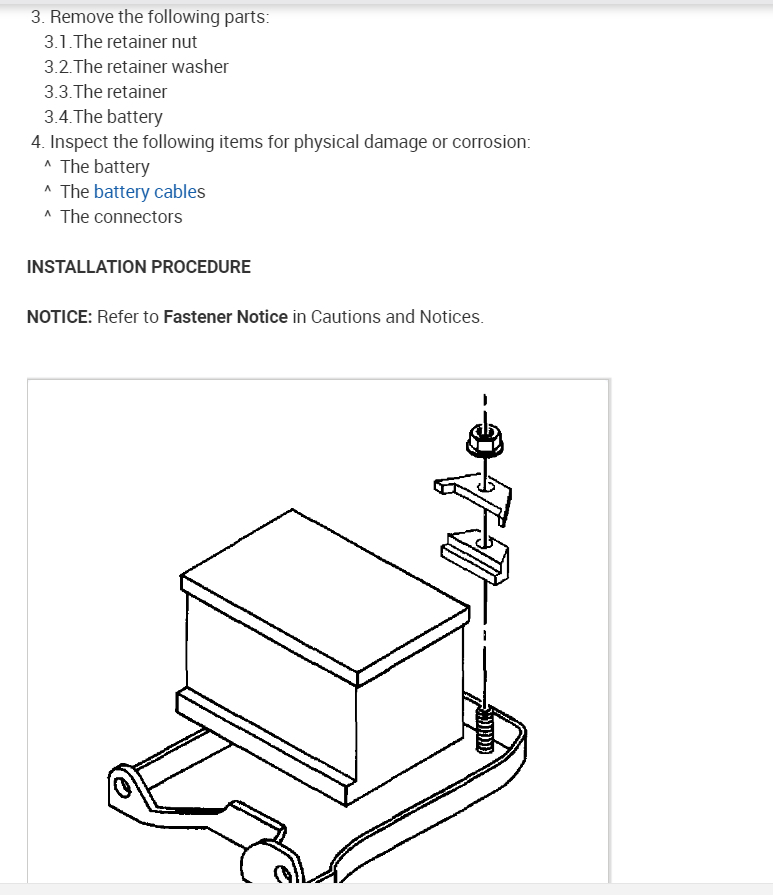

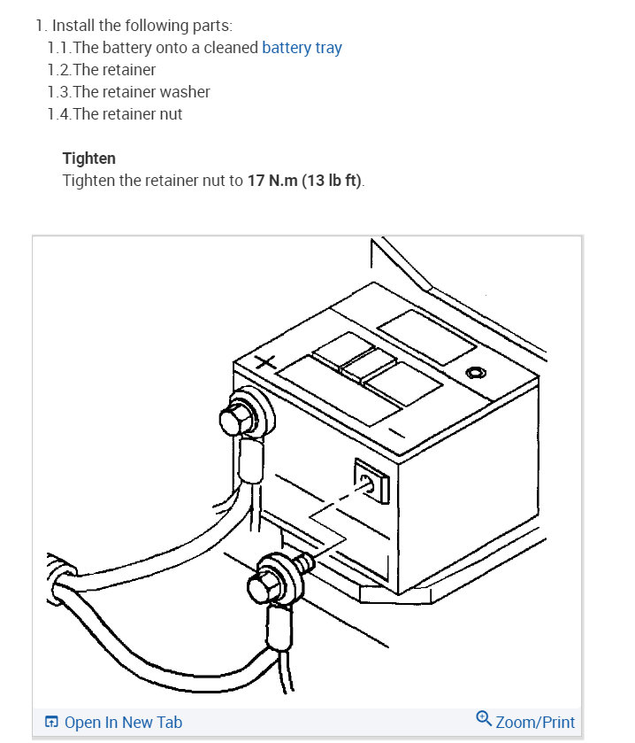

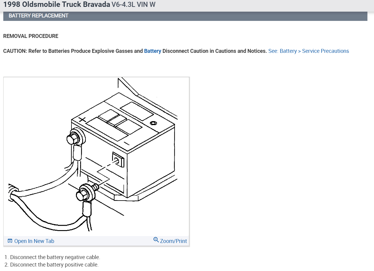

Yep, it sounds like the battery is no good, I would get a new one and install it. Here is a generic guide that can help with instructions in the diagrams below to help with your car:
https://www.2carpros.com/articles/how-to-replace-a-car-battery
Check out the images (below). Please let us know if you need anything else to get the problem fixed.
