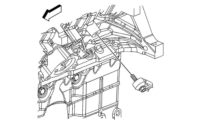

The 327 is a knock sensor. The possibilities are below:
P0327
Descriptor
Probable Causes
Engine Control Module (ECM)
Knock Sensor

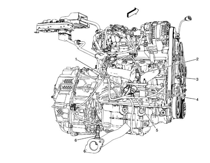

COMPONENTS
Powertrain Component Views
Top View of the Engine
1 - Fuel Injector 6
2 - Fuel Injector 5
3 - Fuel Injector 4
4 - Camshaft Position (CMP) Sensor
5 - Fuel Injector 1
6 - Fuel Injector 2
7 - Fuel Injector 3
Top of the Engine
1 - Generator
2 - Ignition Control Module (ICM)
3 - Manifold Absolute Pressure (MAP) Sensor
4 - Throttle Actuator Control (TAC) Module
5 - Evaporative Emissions (EVAP) Canister Purge Solenoid
Front of the Engine
1 - Heated Oxygen Sensor (HO2S) Bank 2 Sensor 1
2 - Engine Coolant Temperature Sensor
3 - Transmission Control Module (TCM)
4 - Fusible Link
5 - Starter
6 - Knock Sensor (KS) Bank 2
7 - Engine Oil Pressure (EOP) Switch
8 - Heated Oxygen Sensor (HO2S) Bank 2 Sensor 2
9 - A/C Compressor Clutch
10 - A/C Refrigerant Pressure Sensor
Rear of the Engine
1 - Knock Sensor (KS) Bank 1
2 - Heated Oxygen Sensor (HO2S) Bank 1 Sensor 1
3 - Camshaft Position (CMP) Actuator Solenoid
4 - Engine Block Heater Connector (K05)
5 - Crankshaft Position (CKP) Sensor
6 - Heated Oxygen Sensor (HO2S) Bank 1 Sensor 2
