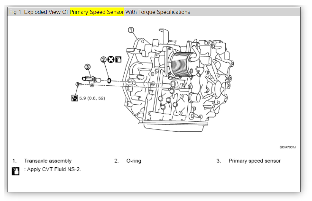

This happens when the input shaft speed sensor goes out. To be sure let's run the codes. I have included a guide to help you and the location of the sensor in the diagrams below.
