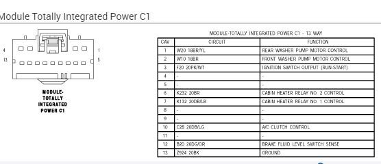

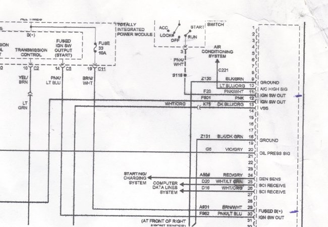

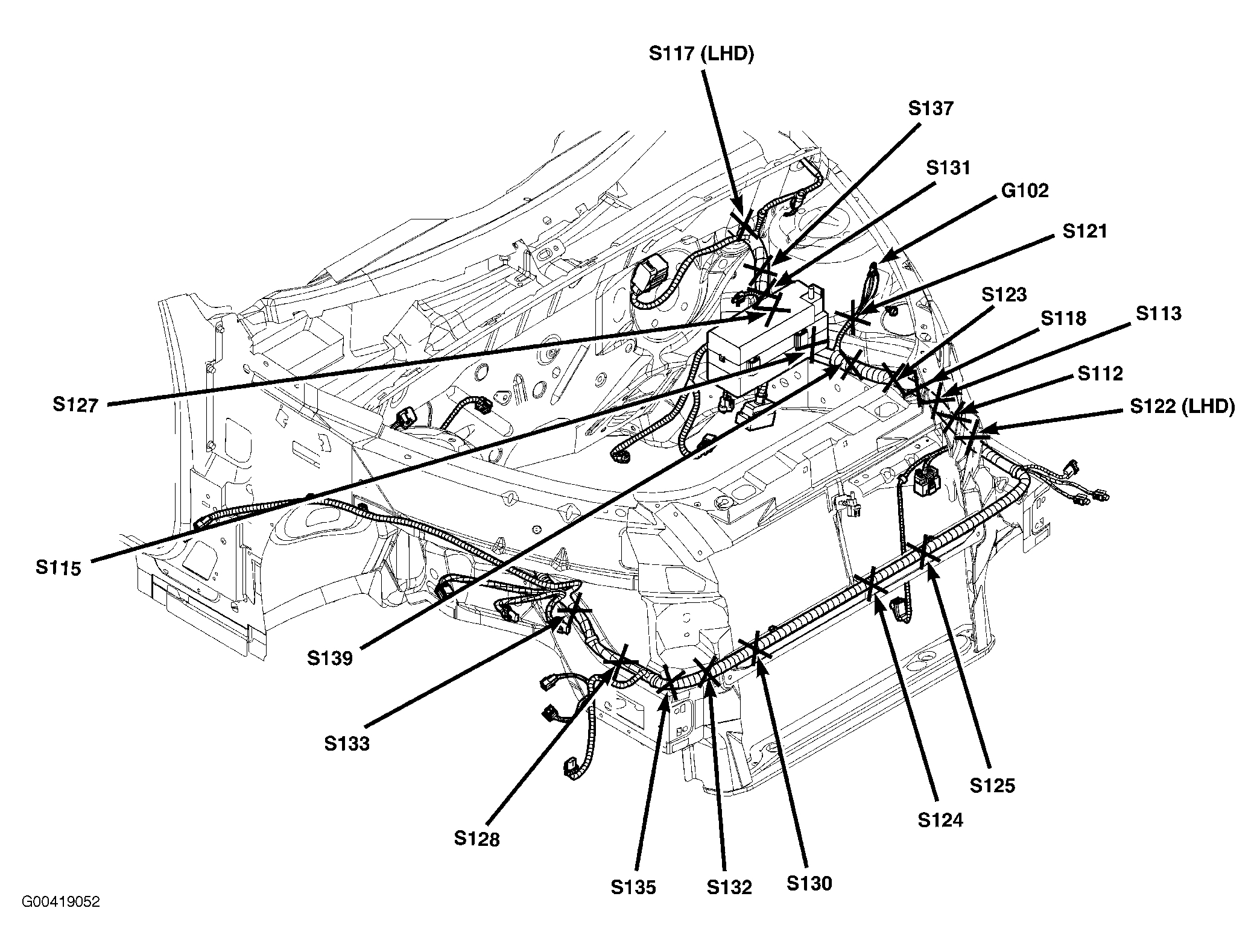

Hi again. I'm not sure what problem you are dealing with. However, based on what you have said, it sounds like a start issue. Is that correct? As far as the s118, please reconfirm that number. I just looked through every schematic and can't locate it. I found s117 and s119. My next question is this. Power to the PCM is supplied through the TIPM (total integrated power module). These are very common to have issues because of the small pin size and corrosion. Looking at schematics, I'm seeing pins 4 and 5 providing power to the system via the ignition. Have you checked them?
Let me know exactly what is going on. Also, what engine is in the vehicle. The 2.4L wasn't offered in this vehicle.
