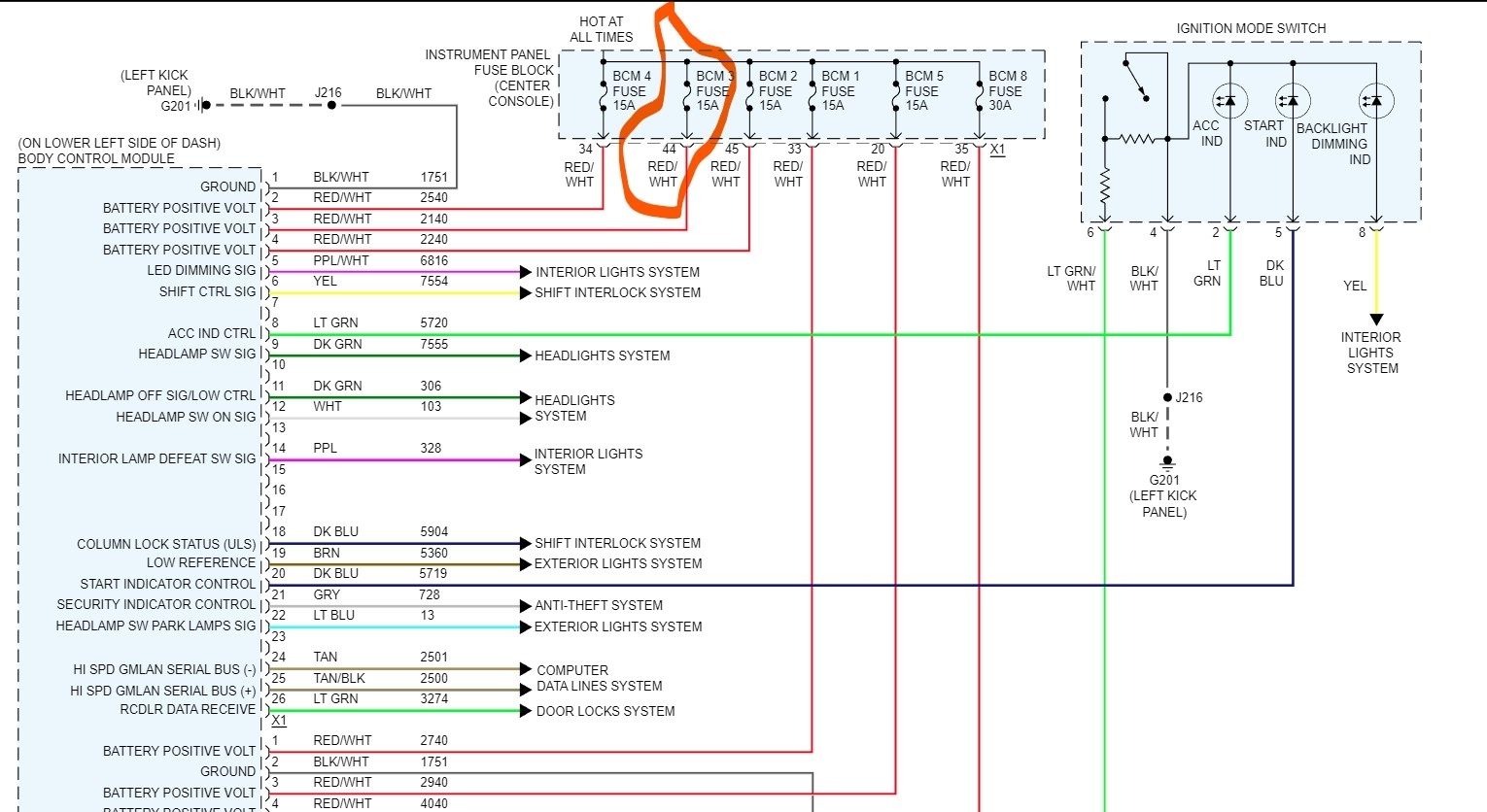

Check engine light came on. Plugged in my obd2 scanner and there was no power to the socket. In the process of finding the blown fuse for the diagnostic port i pulled out the fuse for the BCM#3.
A lot of servos or motors started making a lot of noise, so I put it back in fast. I found the blown fuse and powered up the diagnostic port. Check engine light is out but touch screen is not working.
I did some research and came across a trick i have used before but didn’t know it was called a capacitor discharge.
It didn’t make things worse, but the touch screen, radio and parking assist are still disabled.
Thats all i did so what happened?
Did i fry the BCM by removing a fuse?

It's possible that removing the fuse did some damage but the only way to know for sure would be to connect a dealer level scan tool and see what it shows in regards to the internal errors that may be in the module. It's possible that pulling the fuse only made the module go stupid and it needs to be reprogrammed to make it operational again. Service information doesn't really show what that fuse does other than battery voltage.
