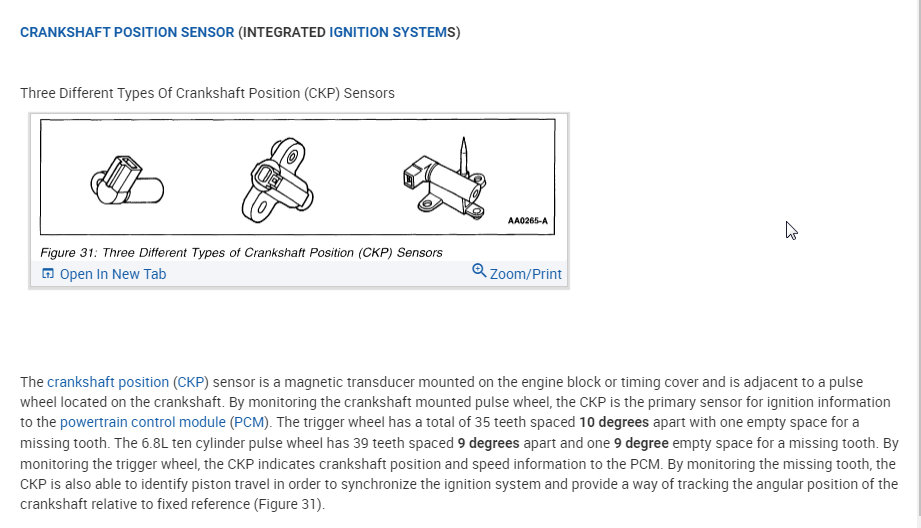

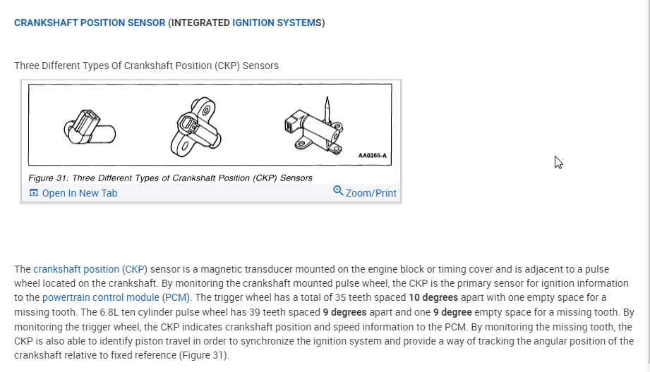

When i got this SUV previous owner told me that it ran good until one day it wouldn't start. So he had the starter and fuel pump replaced. Still wouldn't start. So i bought it for cheap and i completely went through the engine. I ended up rebuilding the engine, and when i was done i tried to start it, it still wouldn't turn over. So i checked the power distribution box and i replaced it with a used one from an auto salvage place. Replaced some fuses and relays still wouldn't turn over. I went and got a different ignition switch still nothing. I did rent a diagnostic plug in and it was saying that the PCM does not match the VIN. So i went and bought a new PCM with 2 new keys and i programmed the keys . i followed step by step directions on how to do it which was sent by the place where i purchased the computer. It cranked but wouldnt start, tried again and it doesn't do anything no crank no start. I'm not getting spark to coils and also not getting fuel to injectors, fuel pump is good i can hear it when i turn the key. What could be wrong?
