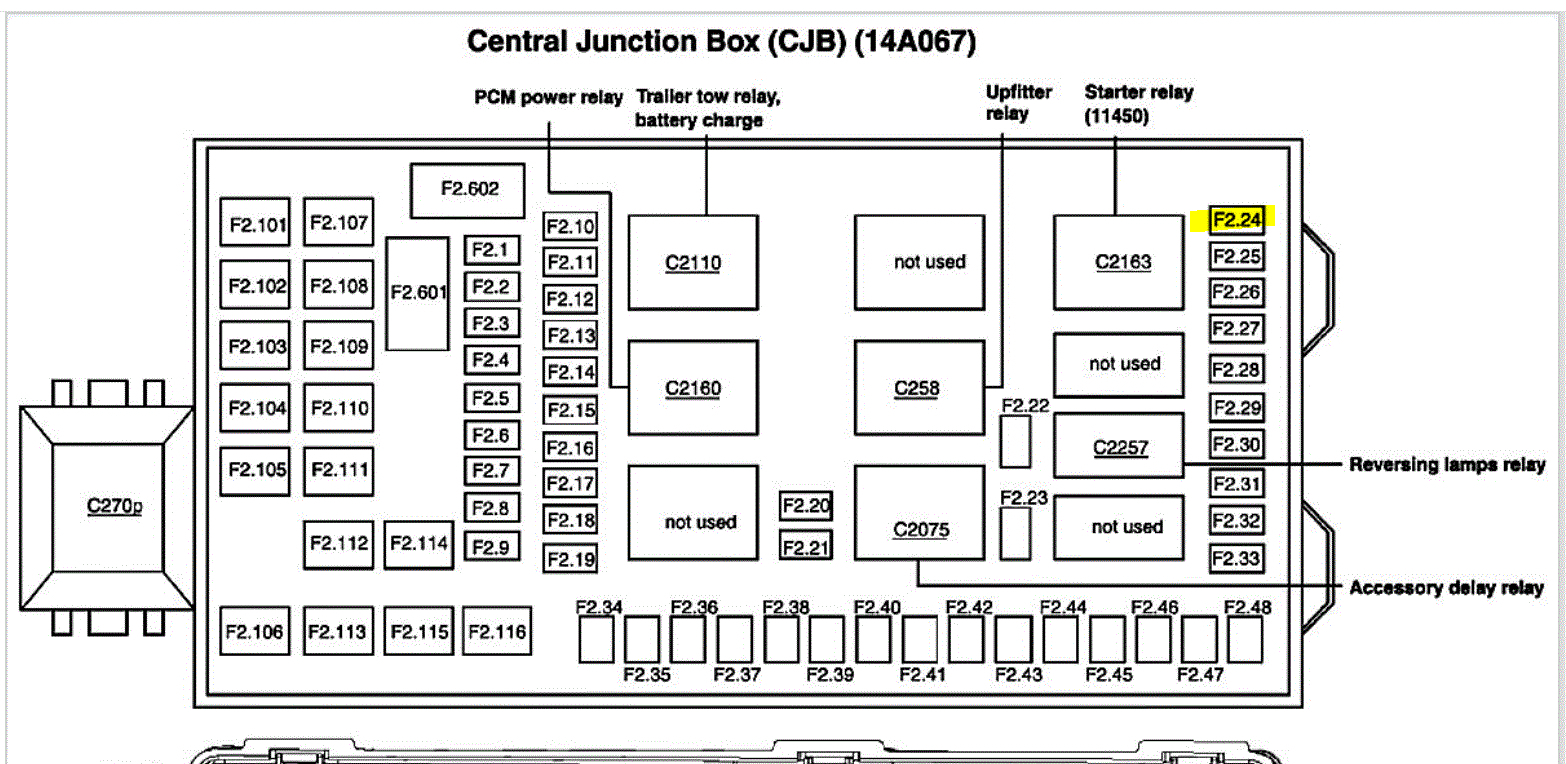

Which sensor was replaced? Was it on the left or right side? Also, did you check fuse 2.24 in the central junction box? It powers the tow/haul switch. See pic 1 below for the location.
When testing it, first confirm the fuse is good. If it is, confirm there is power to it. Here is a link that you may find helpful:
