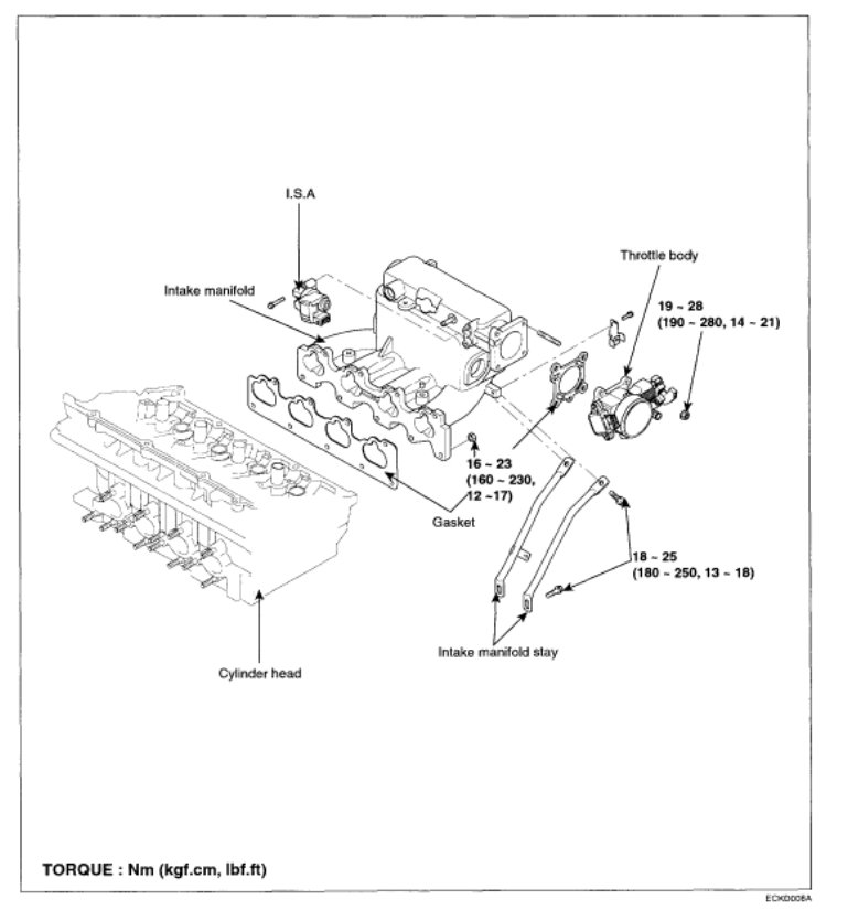

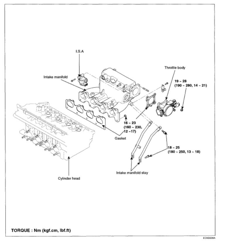

This sounds like you have a throttle body and idle air control valve that is dirty and needs to be serviced which is normal for the miles, what happens is the gunk or choking as they call it inhibits the operation of the throttle body and IAC. Here are two guides with diagrams below to show you how:
and
https://www.2carpros.com/articles/idle-air-control-valve-service
