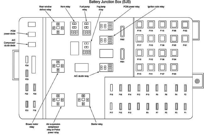

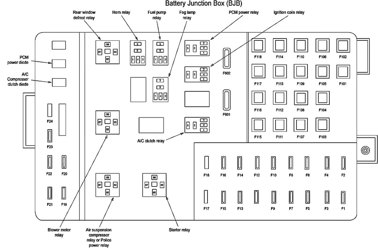

Okay, also, check all fuses int he under hood fuse panel, you might have one that is out.
This guide can help:
Please go over this guide and get back to us. Check out the images (below).
