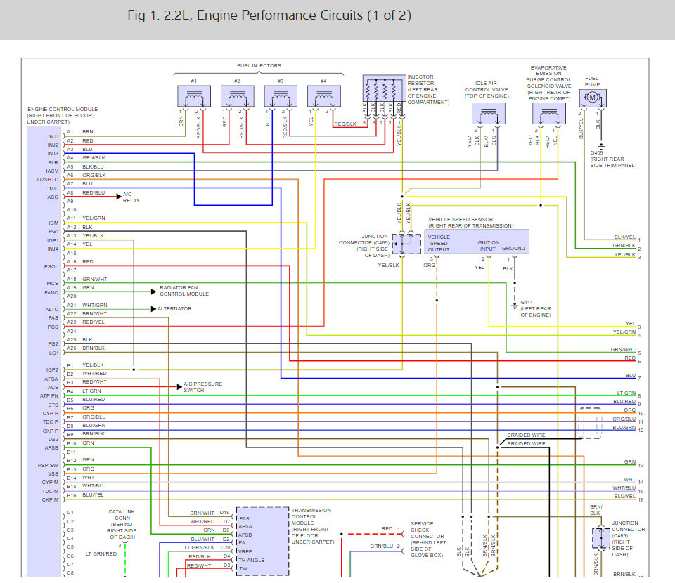

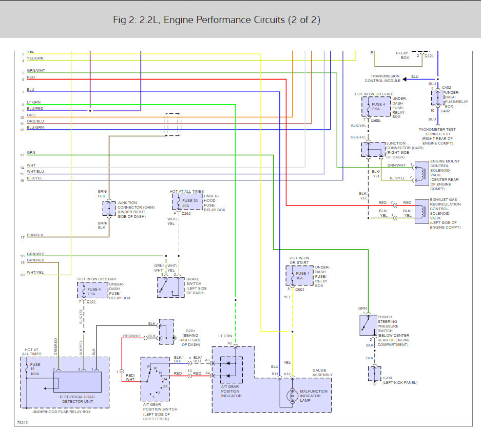

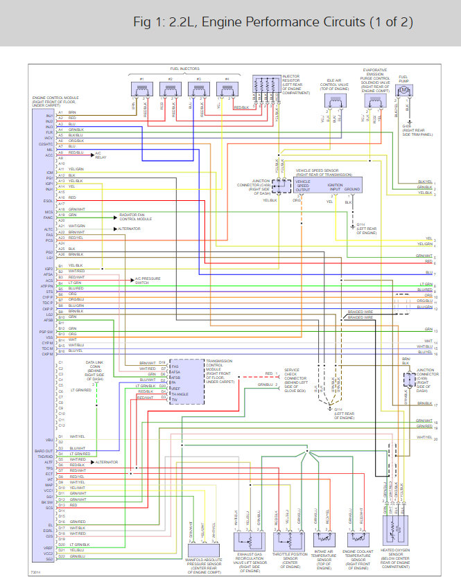

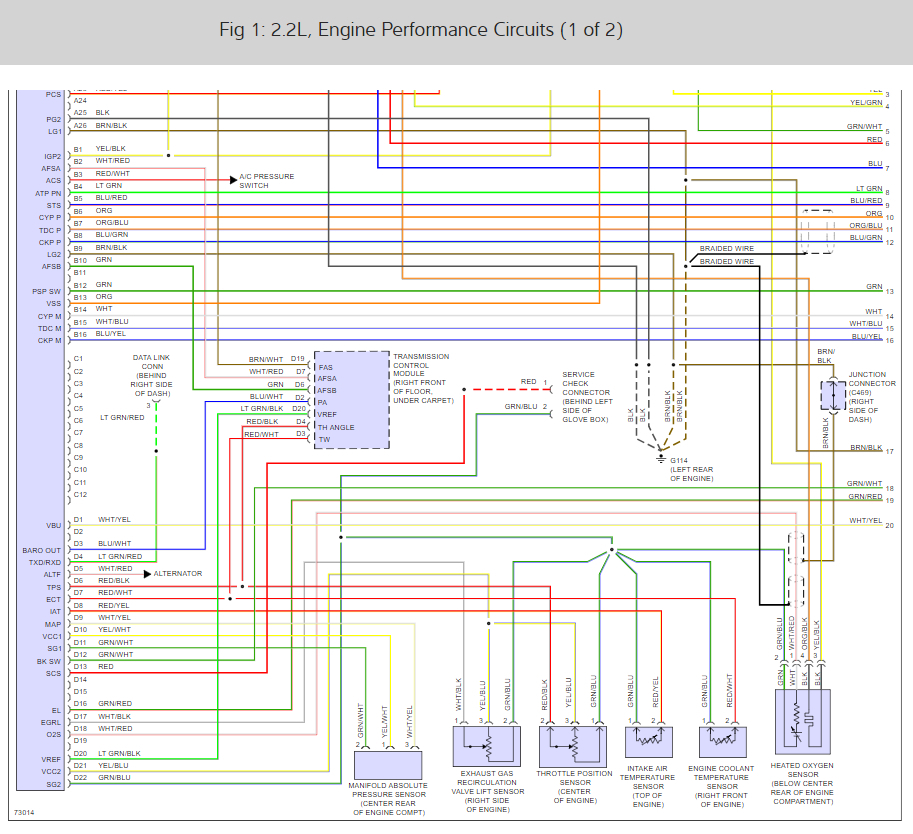

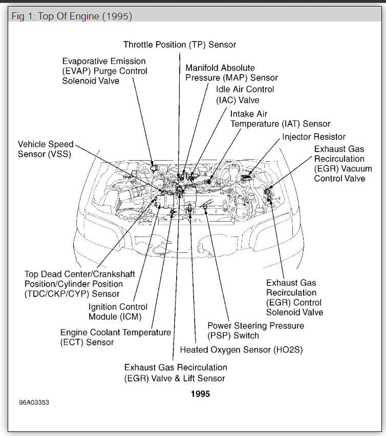

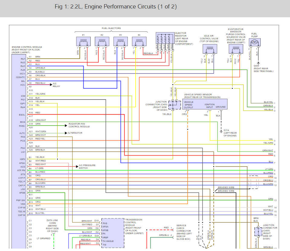

There is an injector resistor that goes bad in these cars. Here is a wiring diagram and the resistor location among with the guide to help you confirm the failure:

Pulled the injector resistor to check the impedance. All terminals checked out low. No open/high impedance. All injectors have voltage as well. Your thoughts?

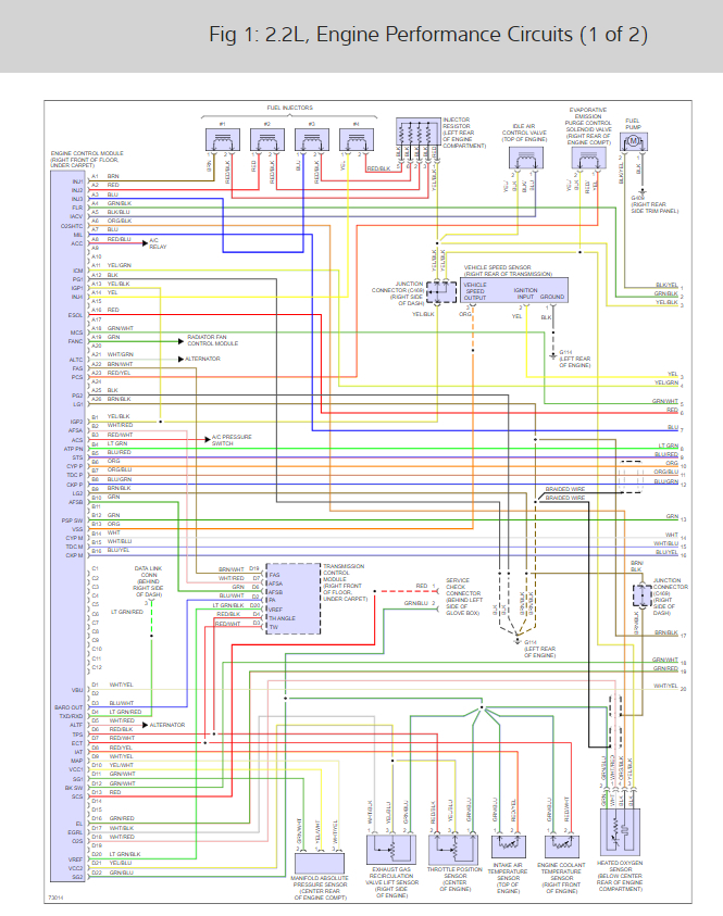

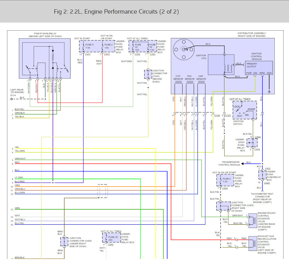

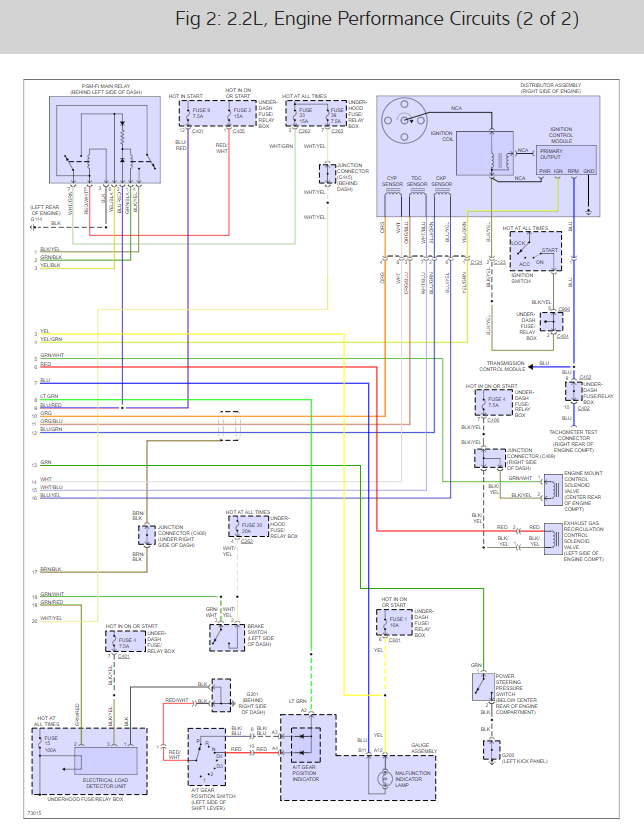

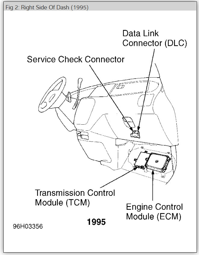

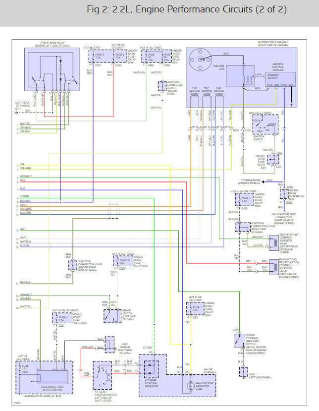

To confirm you replaced the PGM FI relay? If so lets do a ground and power test to the PCM to makes sure the computer is getting powered up. Also, have you checked for power at fuse # 9, 2, 33, 39?
and
Please use the wiring diagrams below. Please run down this guide and report back.

I checked all fuses, the injector resistor, and the PGM FI relay. Fuses all good, injector resistor values within 5 -7 ohms range, PGM FI is getting voltage when key is on. Terminals 1, 3, 5 have constant 12 volts while terminal 7 with Y/B wire to the pump gets 12V for two seconds only once relay operates. What should I look at next? Still have codes 13, 14, 7, and 8 flashing with service connector jumper-ed.

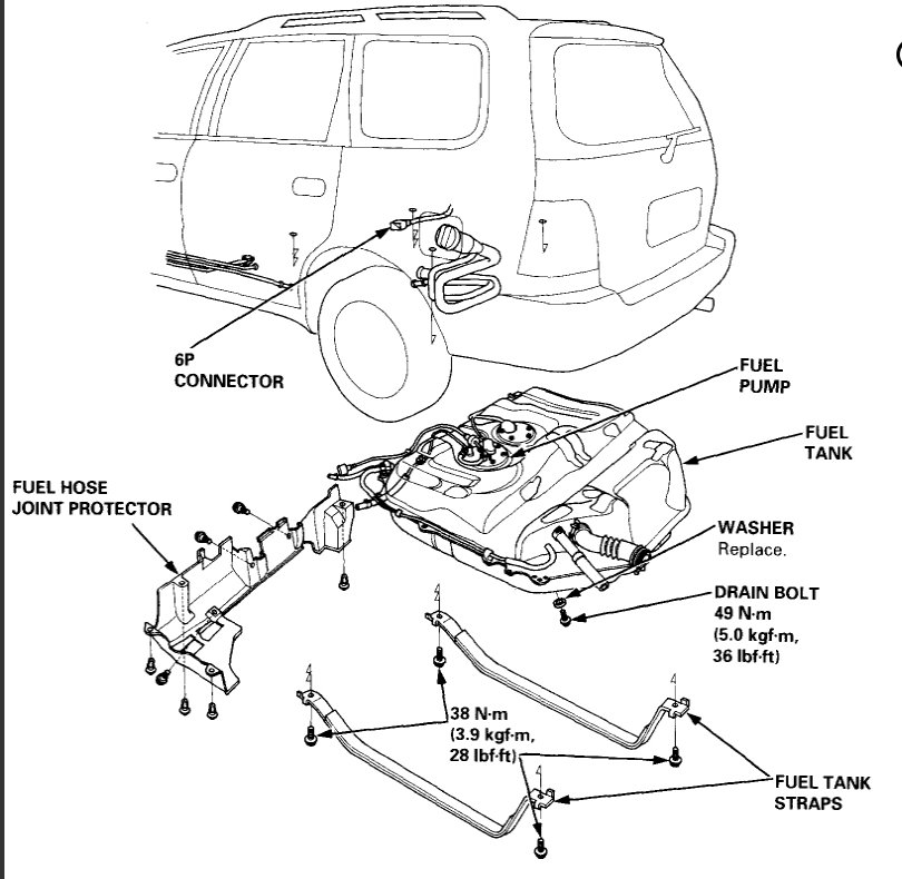

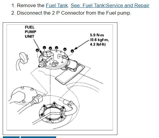

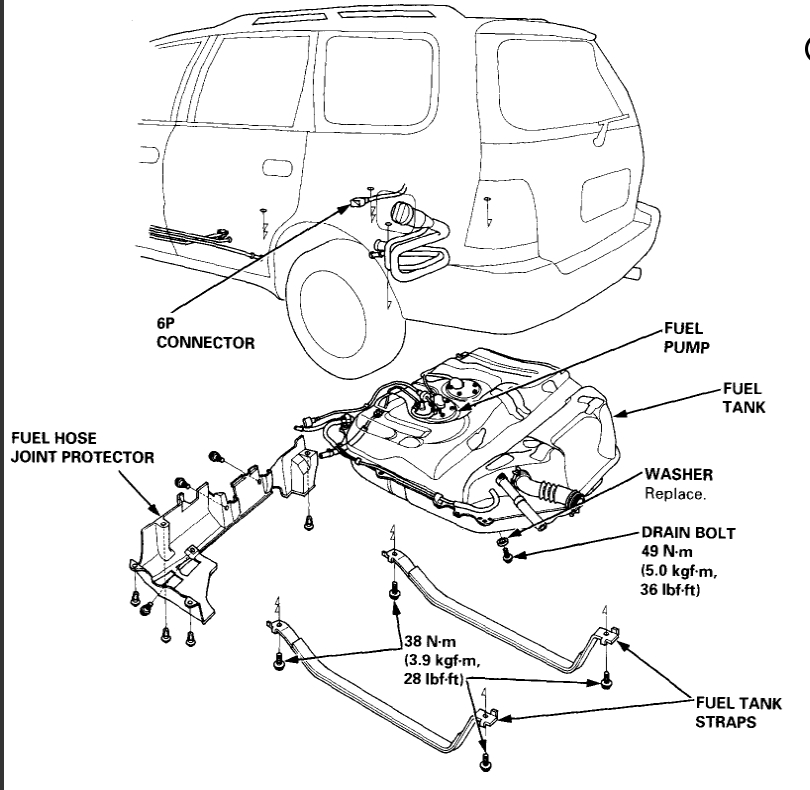

Spark is present at the high voltage coil terminal when cranking. Switched rotor/cap. Pulled one plug and grounded, appears slight spark is now present when cranking. Just verified that power was present at the fuel pump, but the pump is not working. Appears a hole needs to be cut in the floorboard to access the top of the fuel pump. I will try changing out the fuel pump and get back to you. Thank you.
May 29, 2018 at 6:49 AM
Yes, I would drop the tank it would be easier than cutting a hole. Here is a guide and diagrams to help you:
