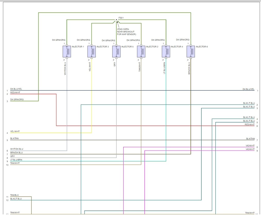

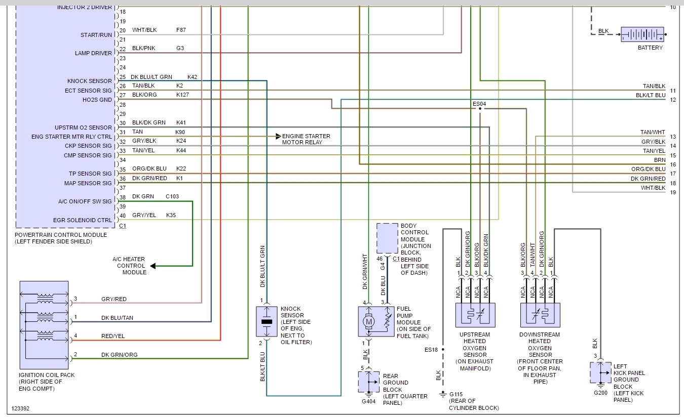

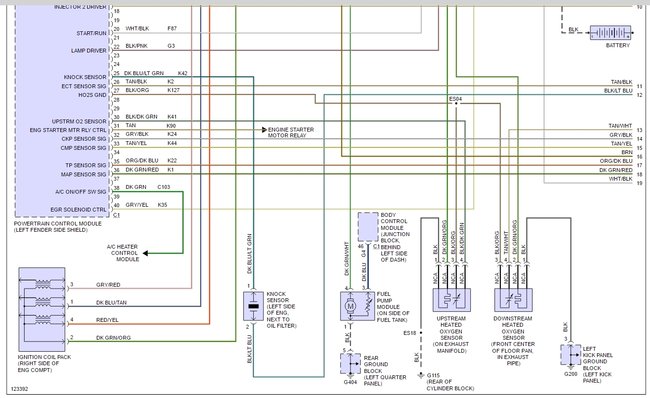

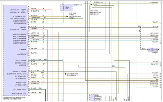

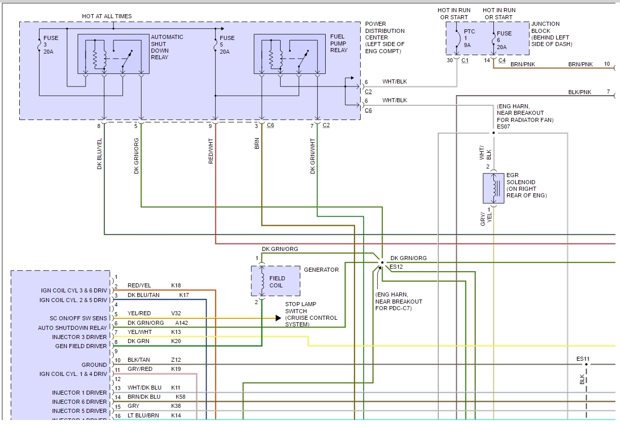

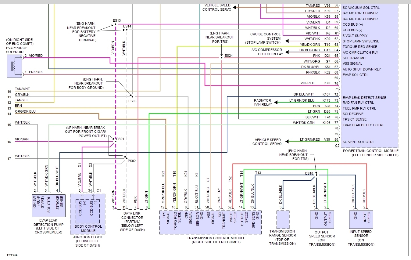

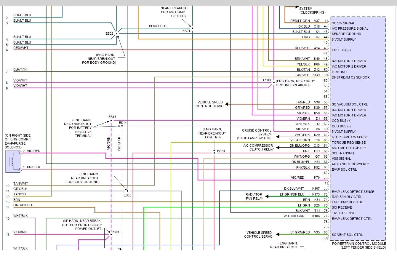

If I may butt in here it sounds like you have a bad PCM which is common on these cars. But to be sure do a pin to pin check here is a guide.
Also I found these wiring diagrams for you.
