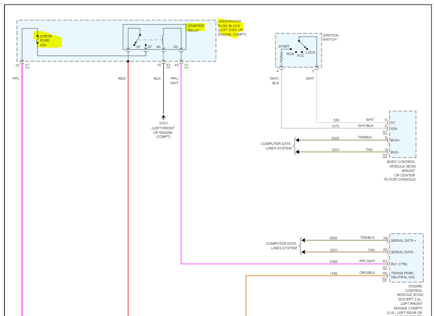

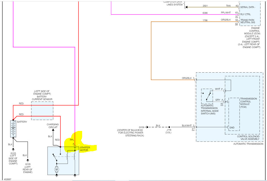

I attached the starter circuit wiring schematic below so that you have a reference. If the click is not the starter, then we need to check for power at the starter.
There will be a smaller gauge purple wire at the starter. It will not have power until the key is in the start position. Have a helper turn the key to the start position while you check for power at that wire.
Let me know what you find.
See pic below. Note: The pic is for the 2.4L engine. If you have the 3.0L, let me know.
