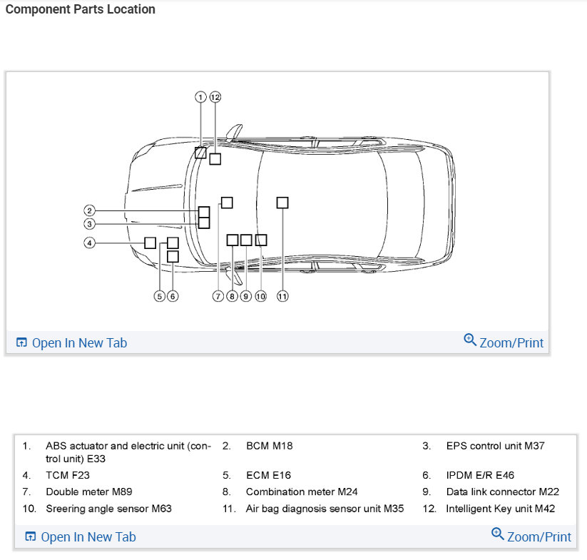

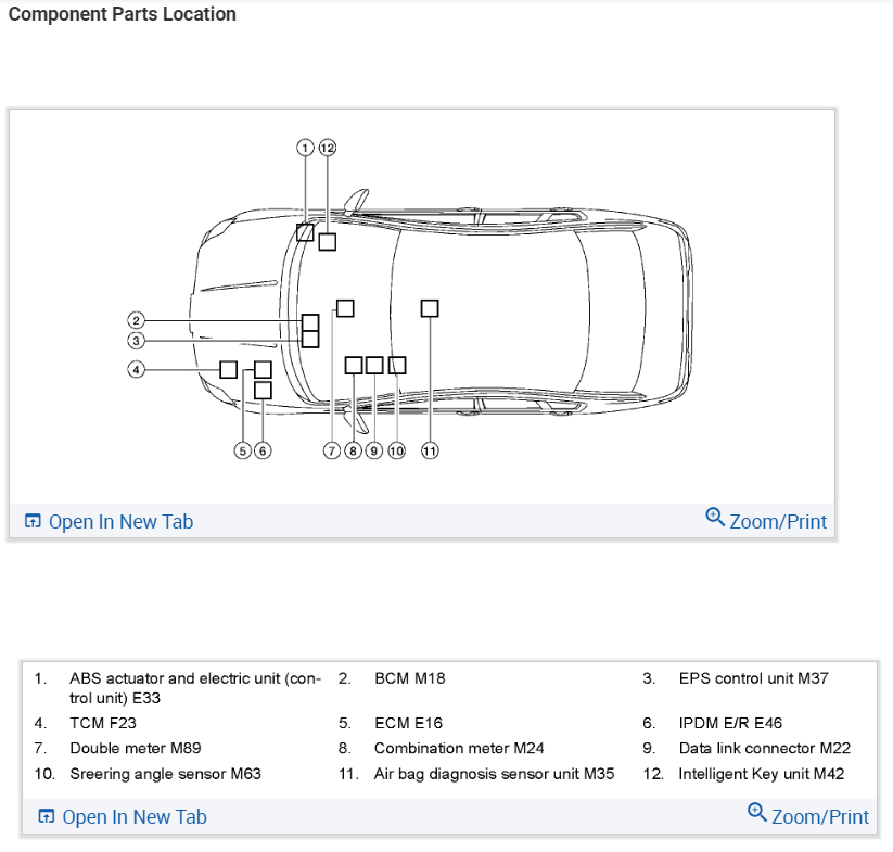

That would do it. here is the location of the ECM you will need to have it programmed to the car should cost about $130.00. Check out the diagrams (below). Please let us know what happens.
