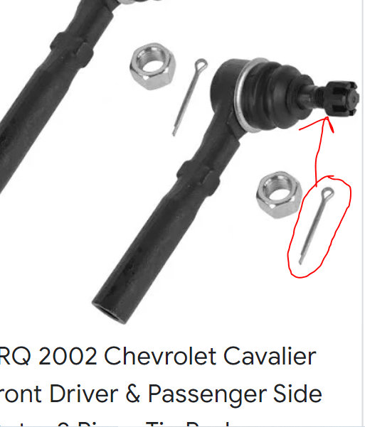

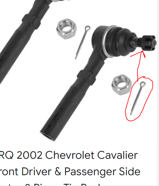

If you haven't, that is what I would recommend. Also, the tie rod should have a castle nut and cotter pin. Take a look at the pic below and let me know if that is what you have.
See pic below.
