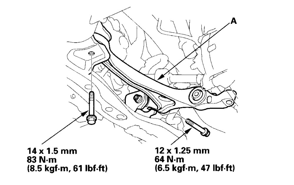

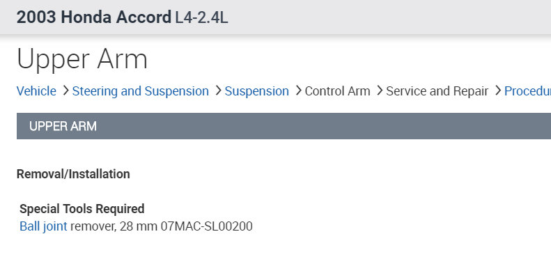

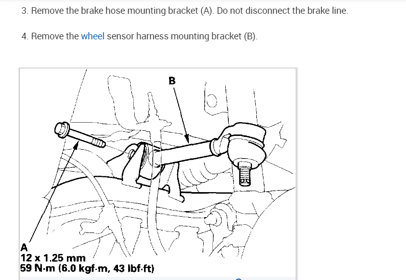

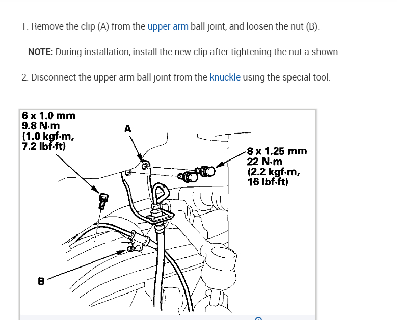

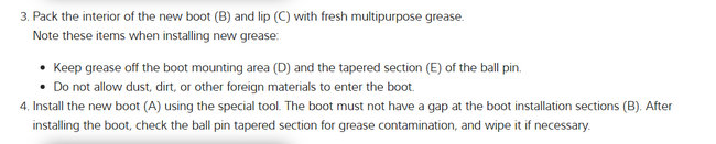

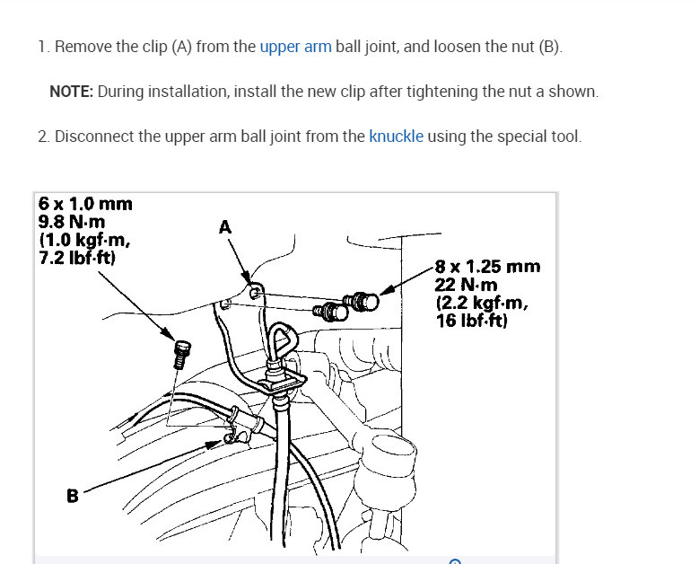

Getting ready to put in a new upper and lower control arm, sway bar link, lower ball joint, and tie rod. I’m using the same fork for the strut. I’m aware some need to be torqued down to spec but i don’t have that information.
