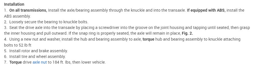

I need torquing specs for the front wheel bearing bolts.
Aug 11, 2022 at 9:21 PM

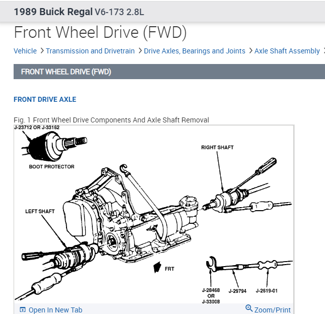

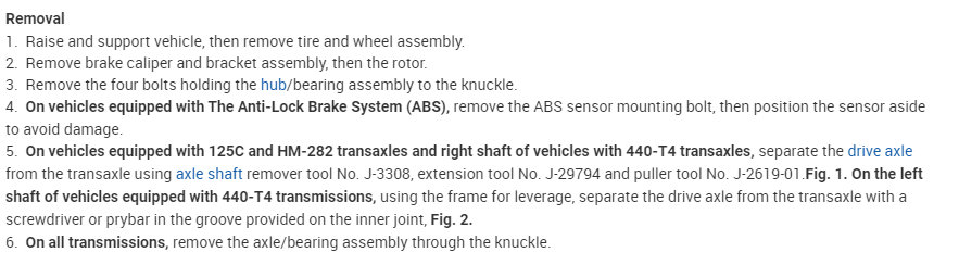

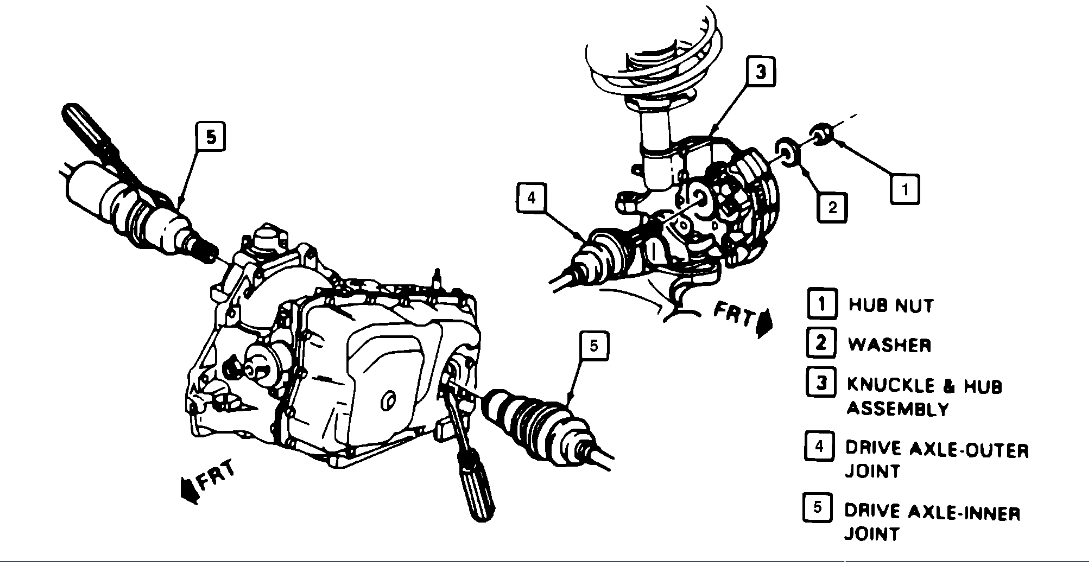

Are you referring to the axle nut?
I attached directions for the replacement of a drive axle. I don't know if that was done or if the hub itself was replaced. However, the directions provide the needed torque specs.
Take a look through the attachments and let me know if you have other questions.
See pics below.

Thanks, I got the info. The info sent will work. Thanks again.
