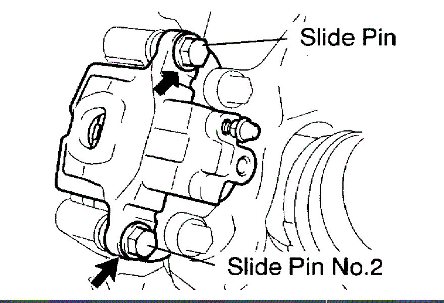

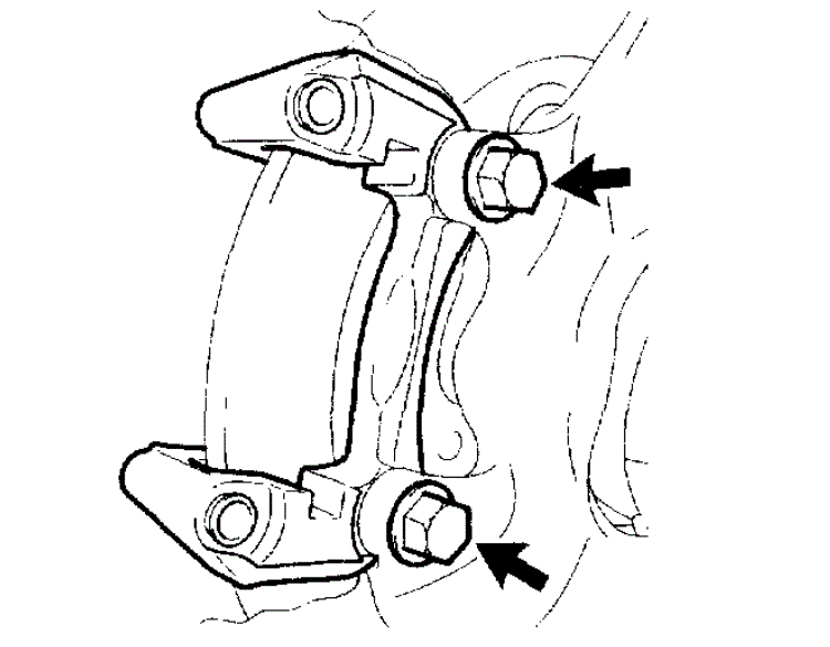

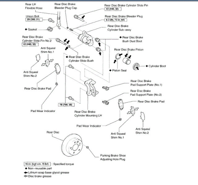

Good evening,
You need to replace the brake pads, both sides, rotor, both sides, and I would replace calipers, both sides as well.
You always replace in pairs with these parts.
I attached a guide for you to follow and some pictures.
https://www.2carpros.com/articles/how-to-replace-rear-brake-pads-and-rotors
https://www.2carpros.com/articles/how-to-bleed-or-flush-a-car-brake-system
https://www.2carpros.com/articles/brake-pedal-goes-to-the-floor
Make sure you bleed the brakes when you are done.
