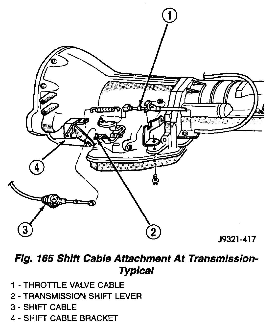

The description makes it sound like there is a linkage problem. The cable runs from the shift lever through the dash and down to the transmission. It clips into brackets at both ends. If the cable were to come out of a bracket it could allow the transmission to shift strangely. If you go underneath the truck and check the cable routing it should be easy to tell. If you have access to a lift or a way to get the wheels off the ground you could move the shift lever to verify that it works in each gear. When the transmission lever is moved fully to the back it is in park. If you shift that lever one detent forward and still have no reverse then there is an internal failure and either a rebuild or replacement transmission is likely the only repair.

If the linkage is not correct the transmission and the pressure control cable would be out of sync. It could actually be in gear while the shift lever is in neutral.

The band shouldn't cause the failure modes you have. A bad linkage or transmission throttle valve cable that is out of adjustment can cause a lot of weird issues as well.
