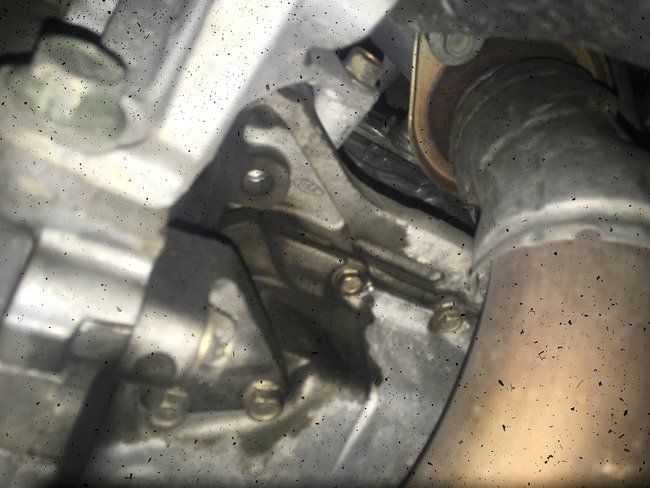

TEE MYSTER
Thanks for the quick response, Alex. I looked under the hood and this is where I noticed the spot of the leak.

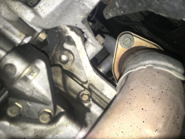

TEE MYSTER
Here is a better image.

SCGRANTURISMO
  • 4,897 POSTS
Hello again,

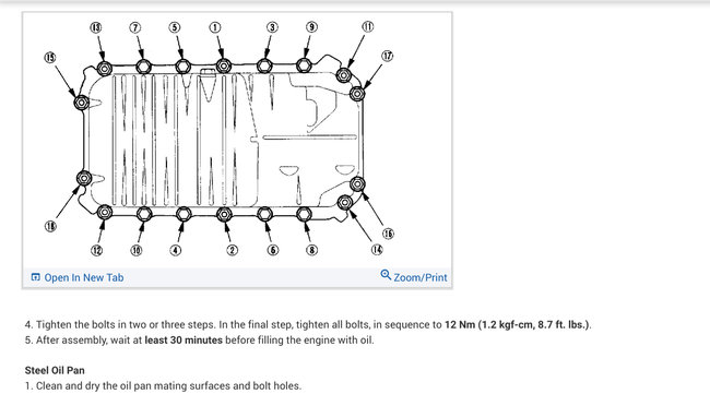

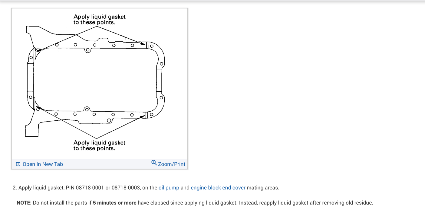

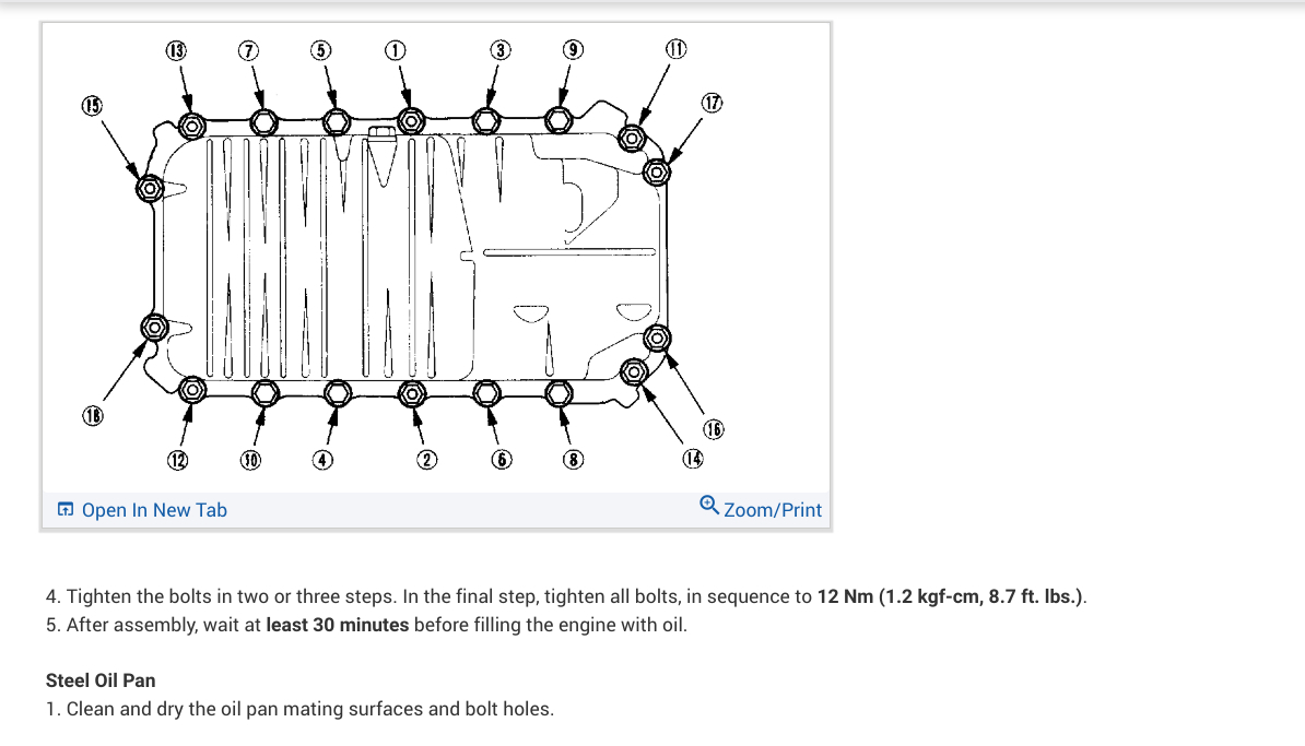

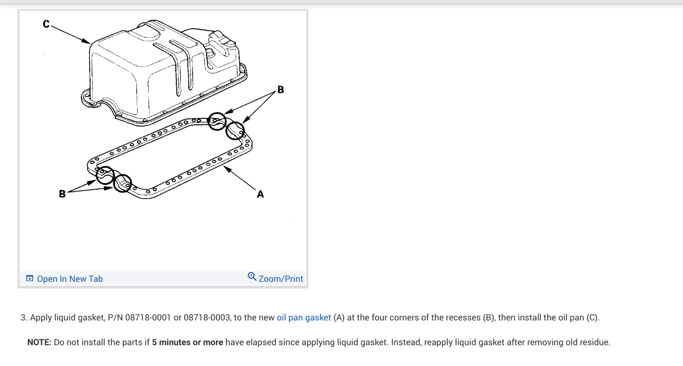

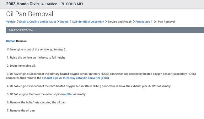

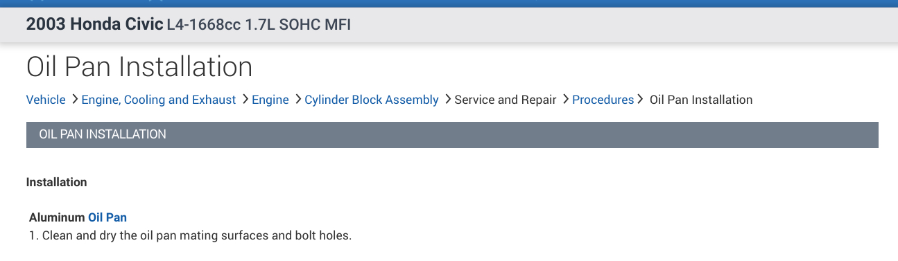

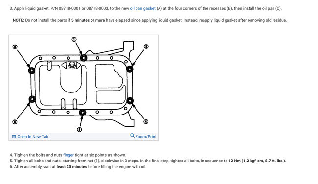

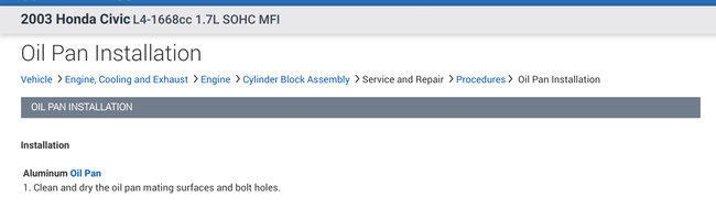

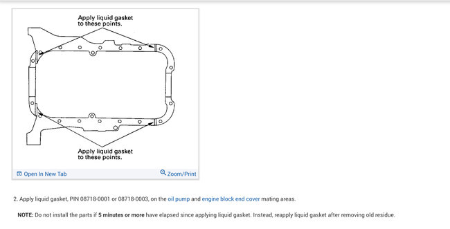

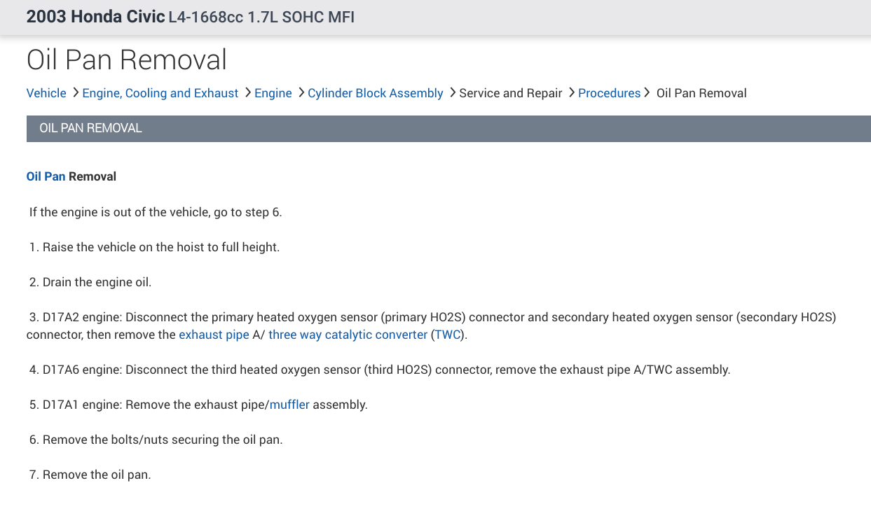

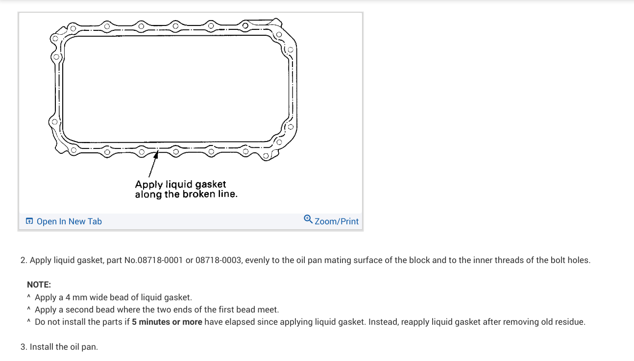

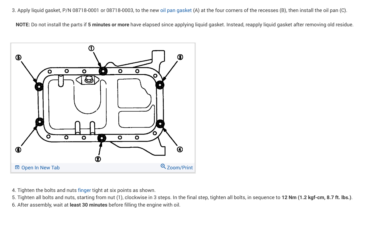

Okay, so that's not a terribly hard gasket to get to, it's the oil pan gasket, which is one of the more common gaskets to fail, so no worries there. In the diagrams down below I have included the instructions for the removal and installation of your vehicle's oil pan. The instructions don't have a pre-made gasket, and call for the use of liquid gasket. I recommend that you use a product made by Permatex called "The Right Stuff". It's a little more expensive, but worth it. Please go through these guides and get back to us with how everything turns out.
