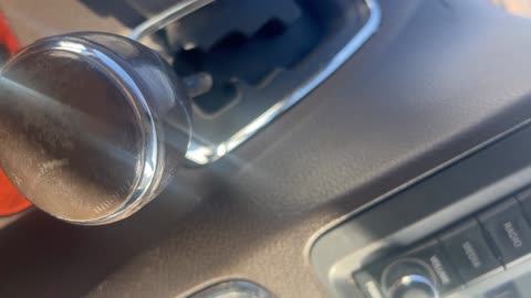

Here is a video. The sound is most evident at the end.

I believe I heard it. To me, it sounds like a low rumble and not a rattle.
It's difficult not to be there, so I need you to check a few things. Please remember that I'm listening to it on a laptop.
Could the noise be coming from the engine compartment? Is the engine oil clean and full? If you open the hood with it running, do you hear anything under the hood that sounds off? For example, a bearing noise from the engine or belt-driven accessory?
https://www.2carpros.com/articles/engine-noises
Next, is there anything that changes the pitch or volume of the noise? For example, if you are driving, hear it, and turn. Does it change? Does it change if you use the brakes?
One final question. Have you inspected the drive axles (CV Axles) for evidence of grease leaking from a boot or excessive play?
https://www.2carpros.com/articles/symptoms-of-a-bad-cv-axle-joint
Look through the links and let me know if anything seems to mirror what you experienced. Also, and I should have asked this first, is the check engine light on, and does the engine seem to be running normally, and am I correct when I say it sounds like a low rumble?
