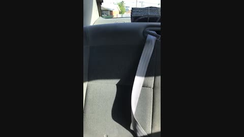

Back with another concern. So just yesterday, I had my shocks and struts replaced, all four. I also had my front lower control arms and rear stabilizer bars replaced. This got rid of my clunk issue that I have had for a while whenever I went over ditches or hit the brakes so that fixed that. However, I have noticed there is this creaking/tapping noise coming from the back right passenger seat whenever I am driving, now I do not know if this is the bolts from the top of the rear seat trim or just a bad installation of the stabilizer or the strut, but I have uploaded a video to show you how that noise sounds while I am driving.

Here is another video I took of me pushing the car up and down from the back right wheel to hear if there is noise coming from there. Did not really hear anything.

Noises can be hard to track down. I have a couple different systems, a chassis ear that uses piezo sensors to "listen" to vibrations from loose/worn parts and a couple cheap digital recorders that I set in the area of the suspected noises.
For the noise you have. Toss some weight in the rear seat and see if the noise changes or goes away. It could be the seat retainer clips or something loose under the seat. It could be that the other noises masked it and now you hear it because they are gone.
It is also possible it is something in the trunk or in the door and it is telegraphing the sound.
You can also just feel around and push/pull on the trim, seats etc and see if something is loose.

I wiggled the back seat, do you think this is the source of the noise?

Could be easily. Toss some weight on it or stuff something under it and see if the noise goes away. If it does pop the seat out and see what is loose. Could be a bad latch or bent support or ?

So I went ahead and put a heavy box on top of the seat, noise is still there, I will shuffle around the rear trim .
Mar 28, 2018 at 9:47 AM
JGONZO2398
  • 372 POSTS
So I sat in the right passenger's seat while someone drove my car. No noise heard as I sat there, I am guessing one of the latches or bolts that holds the seat is loose or something.

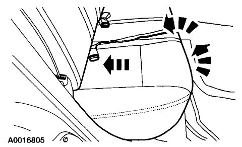

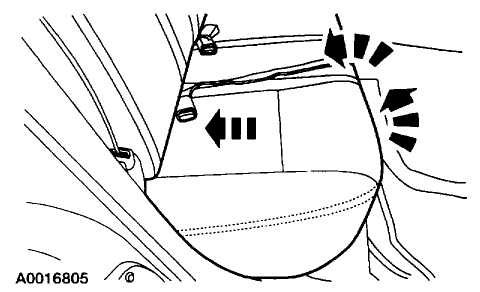

Those come out real easy. Push the seat toward the rear of the car while lifting up. then tip it up and pull it out. That will let you check to see if the latches are bent. From the motion of the seat you showed I am going to bet the tabs are bent and letting the seat bounce as you drive.

So I am sure it is not the lower seats. When I pull on them, they do wiggle but after listening to the noise many times, it is not that. It seems as if the sound is coming from behind the seats, almost sounds like a creaking noise. Here is a video:

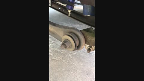

No the noise does not go away if they sit on the other side, and I doubt it is the actual bottom seat latch because the seat does wiggle if you pull on it but that would make a distinct noise. I took a video after I took the rear right tire off, of the brake drum and suspension, I did not see anything out of the ordinary really but this one bushing or rubber boot looking thing on the top left corner looked noticeably cracked, there is a bar sticking out of it that connects to the stabilizer bar, I recorded that. Do you think that could be the issue?

So I typed in my problem on Google and found a Scotty Kilmer video on YouTube. Basically the same issue, creaking noise from the right rear side, and it is the sway bar bushing that needs lubrication, if it is not really cracked, but dry. And I am thinking that is the part in the video I posted. I will spray some lithium grease on it.
May 17, 2018 at 5:14 PM
STEVE W.
  • 15,113 POSTS
Are the sway bar end links purple? That usually indicates they are not rubber but stiffer urethane, which also loves to squeak. You could test that by removing the end link. from that side and see if the noise goes away. If it does you can try applying some silicone grease (like sil-glide) and see if it stops.
That stabilizer bushing on the frame should be replaced as well but those usually will make a clunk if they are completely bad as the bar will hit the mount around it.
May 17, 2018 at 5:19 PM
JGONZO2398
  • 372 POSTS
It is a blue color. And the stabilizer bar was replaced when the shocks and struts were replaced, you are saying they are already bad?

Not bad as in failed, more like the wrong application of a material. Factory rubber bushings are sort of like marshmallows. They can flex and move a lot because they are soft. Urethane is stiffer normally which can improve handling but it also has a bad property of squeaking sometimes. The easiest test is to simply remove the link and see if the squeak goes away. If it does you can apply either silicone grease (will not damage the urethane) or get factory type rubber bushings.
