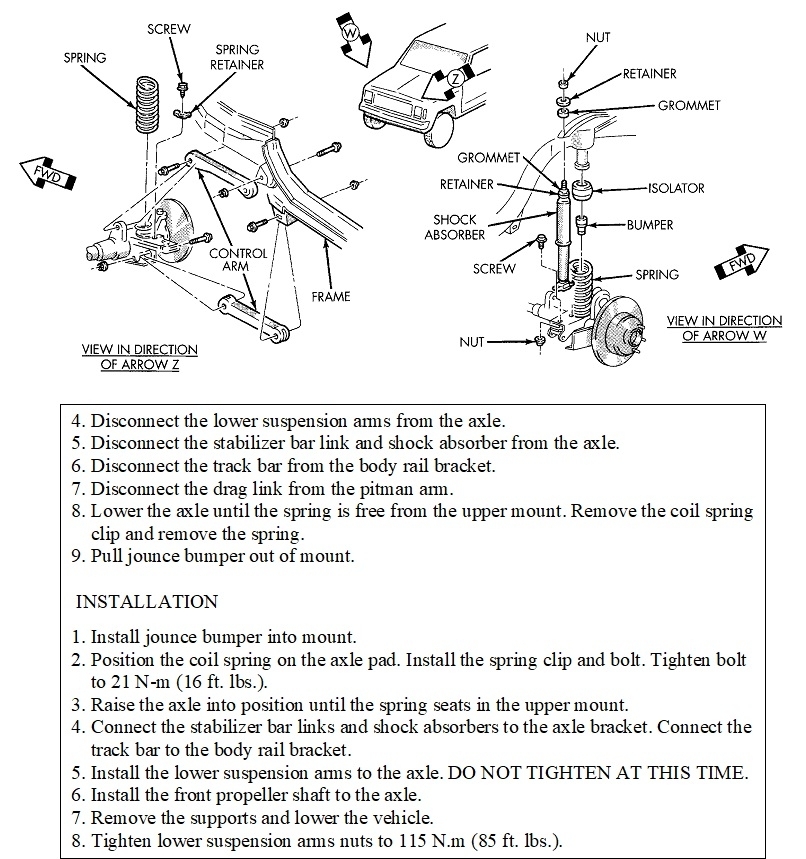

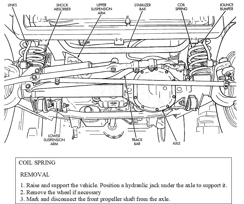

If you don't measure chassis ride height, it is going to very close to specs if new springs are installed. The procedure is shown below. The only step I don't remember is needing to unbolt the track bar. If you do unbolt anything with a rubber bushing on something that rotates, like this one does, it should only be retightened with the vehicle sitting at normal ride height. If you tighten it with the vehicle jacked up and the suspension hanging down, that's where the bushing will be clamped. Once lowered onto the tires and the linkage pivots to its at-rest position, that bushing will be clamped in a permanent twist. That will greatly shorten its life.
