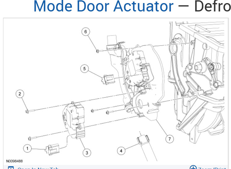

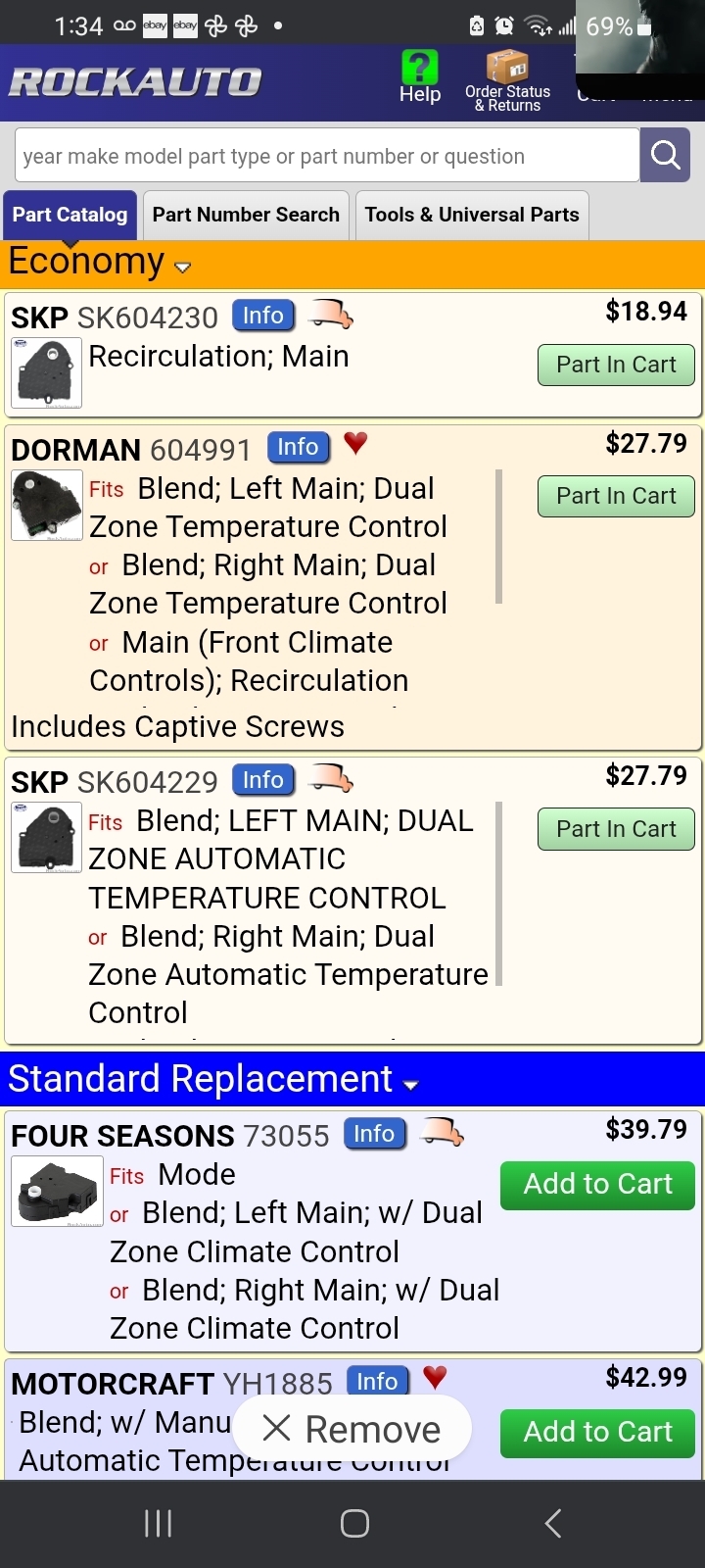

Airflow really weak but still feels slightly cold. When changing to heater, no heat at all from vents. Replaced cabin air filter, and blower motor. Checked refrigerant level and it's within good range. AC line under the hood feels cold and there's quite a bit of condensation falling under the car. I suspect either a blockage somewhere or bad heater blend actuator.
