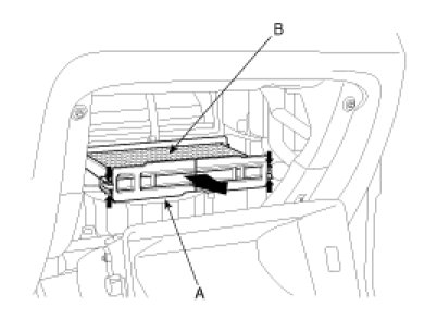

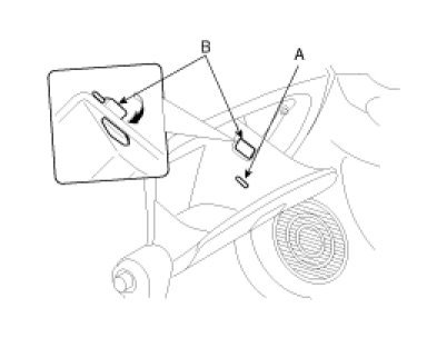

1. Open the glove box. Lower the glove box down completely by removing the tension cord (A) and the glove box stopper (B) to the glove box.

2. Remove the filter cover (A) with pushing the knob.
3. Replace the air filter (B).
