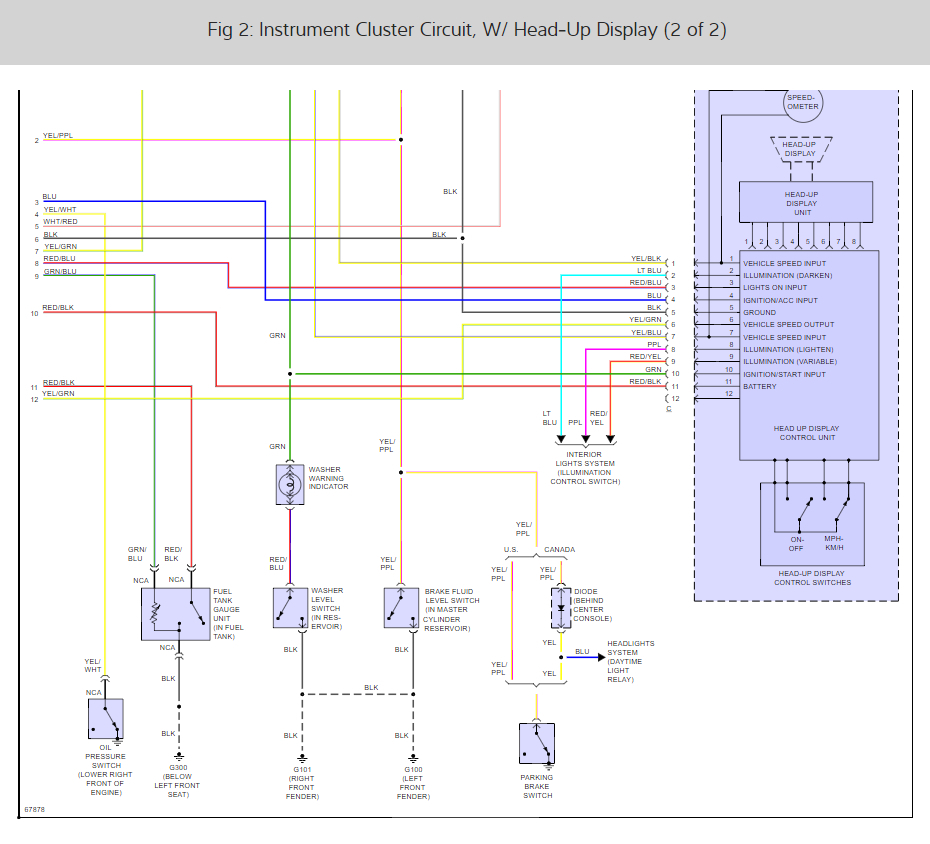

My car which has a digital heads up speedometer display stops working occasionally and the transmission then will not shift out of second gear.
I have had the speedometer sensor replaced from the transmission and it worked for a short period but has reverted to the same situation as before.
Is there another sensor or fuse etc., that could be causing this?
Nov 8, 2017 at 11:00 AM

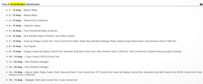

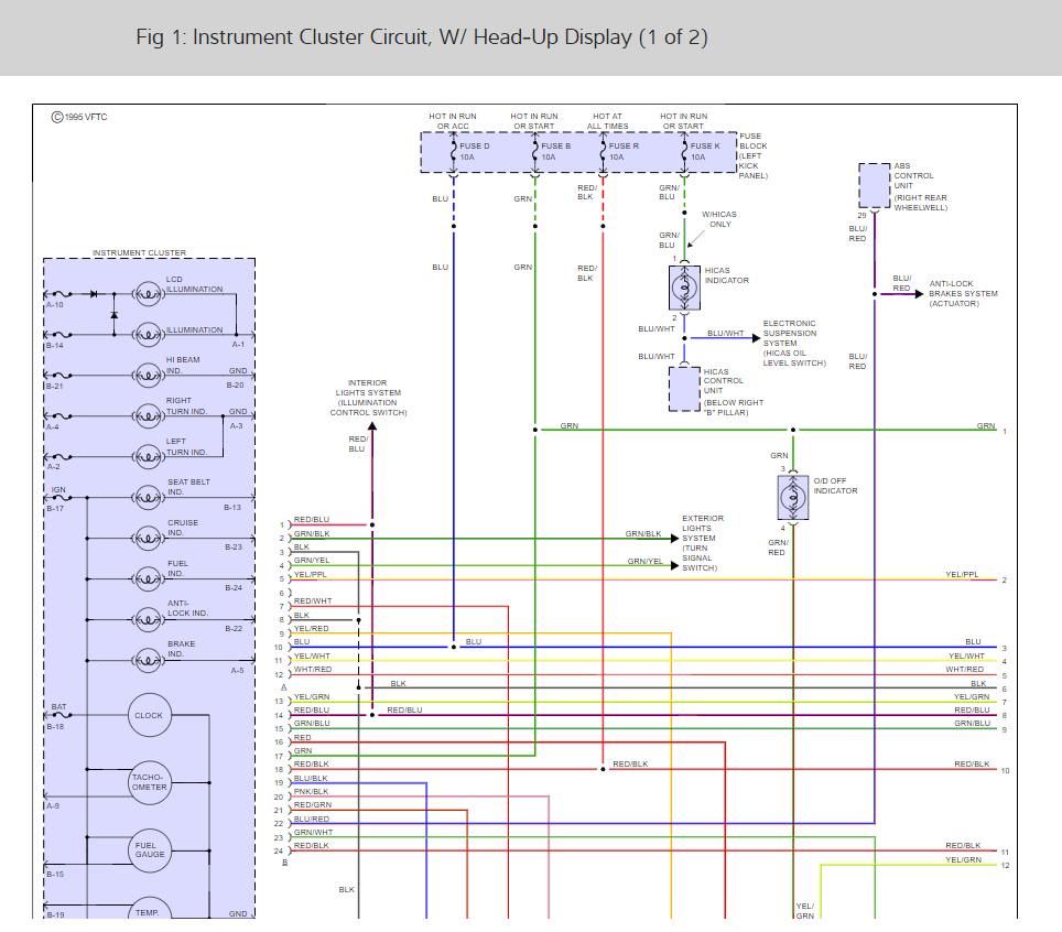

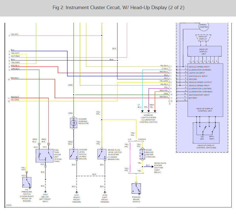

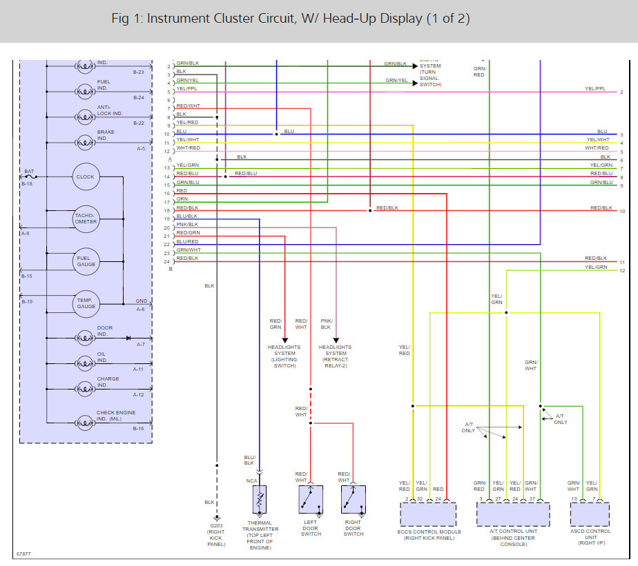

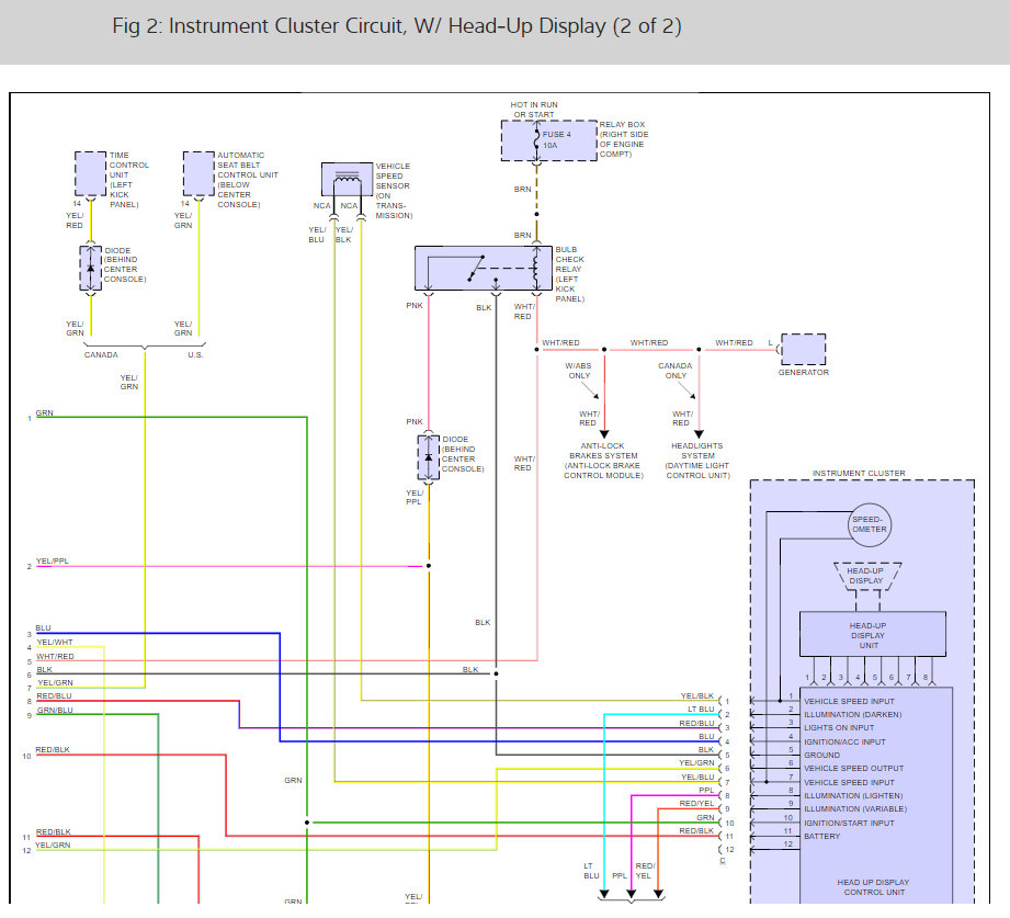

It sounds like you have an instrument cluster that is going out which will affect the transmission shifting as well. But to be sure lets run some checks.
Here is a guide and some instrument cluster wiring diagrams (below) so we can get the car fixed:
and
