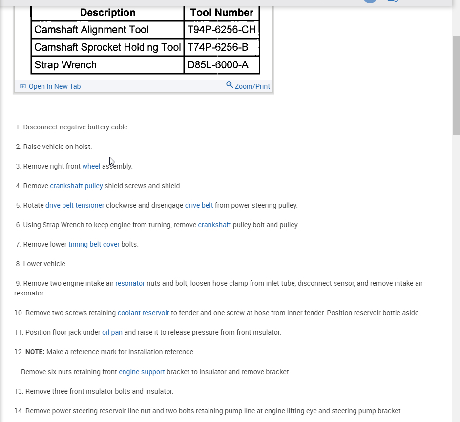

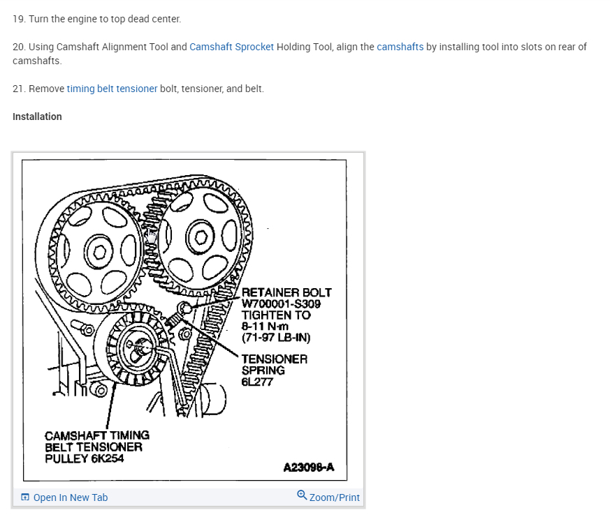

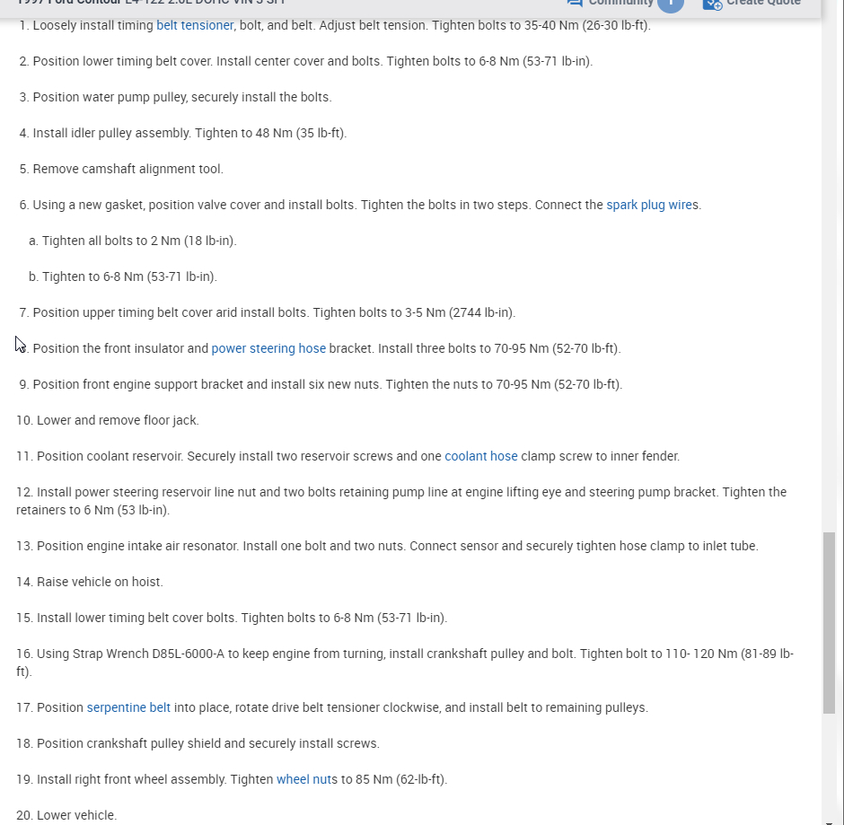

Hi Martman,

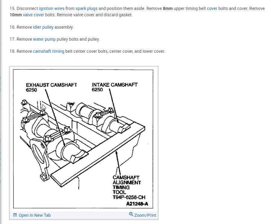

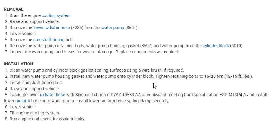

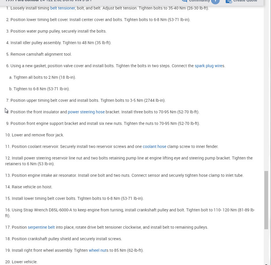

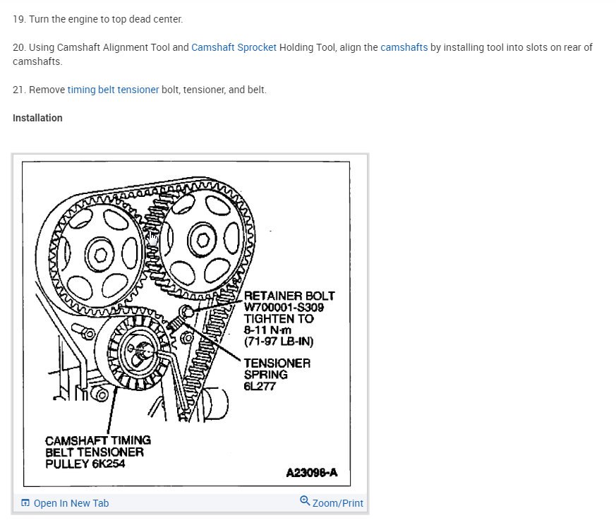

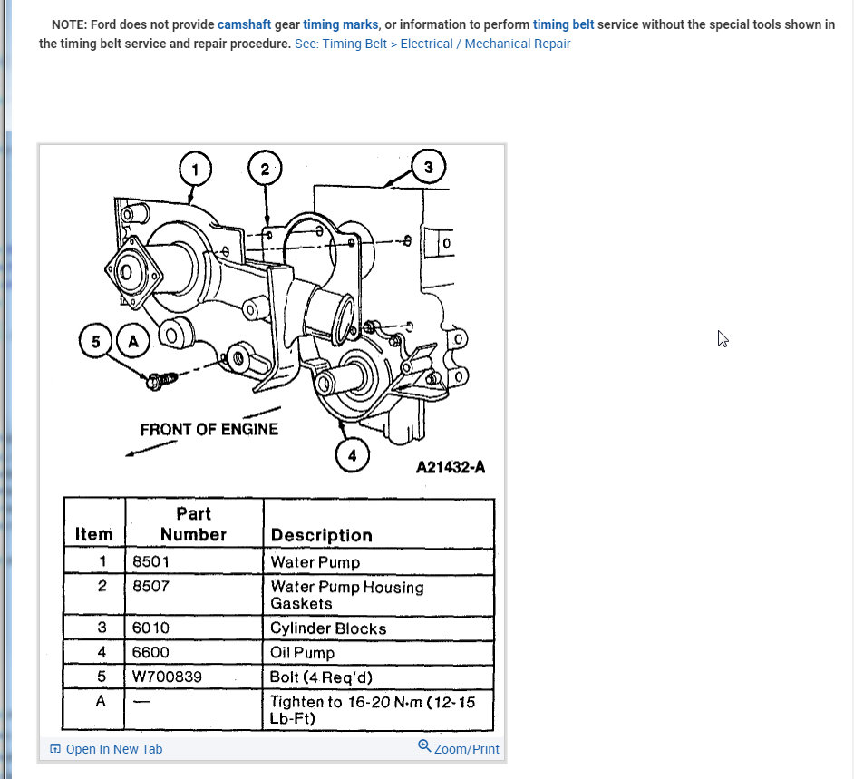

Here is the procedure for replacing the pump. Looks like you need to take the timing belt off so you need to make sure that goes back on correctly. Here is the procedure for that as well.
Let me know if you have questions. Thanks
