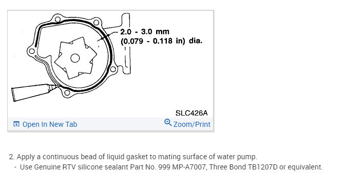

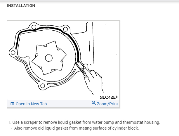

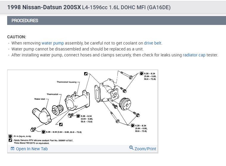

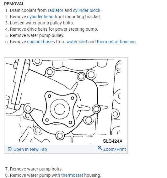

As far as replacement, here is a link that explains in general how it's done. I'm adding this so you have an additional resource to refer to.
https://www.2carpros.com/articles/water-pump-replacement
As far as your specific vehicle, I attached the directions below. I hope they are helpful for you.
See pics below.
