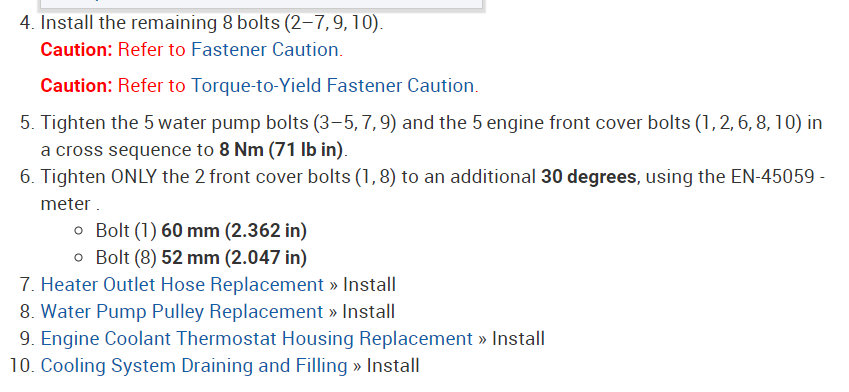

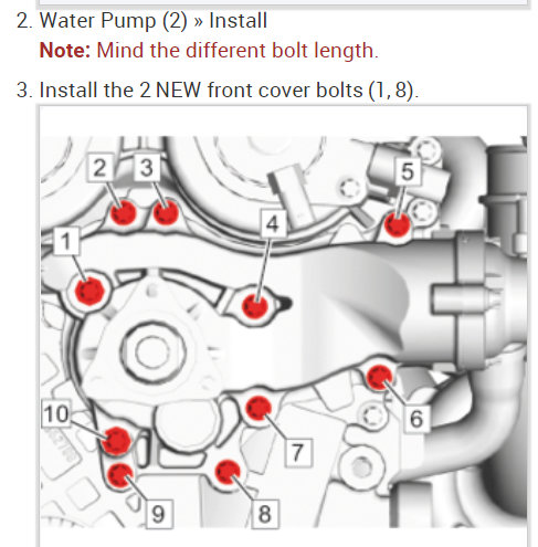

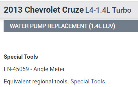

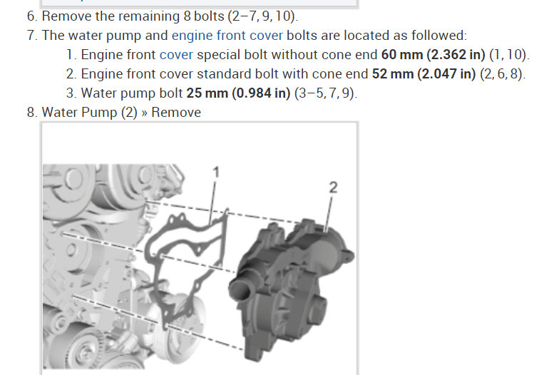

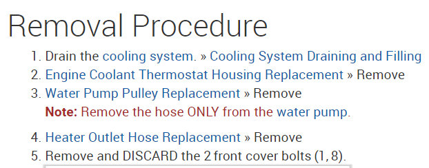

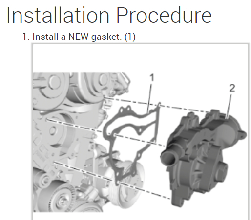

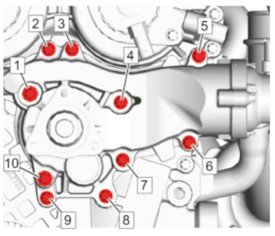

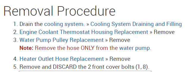

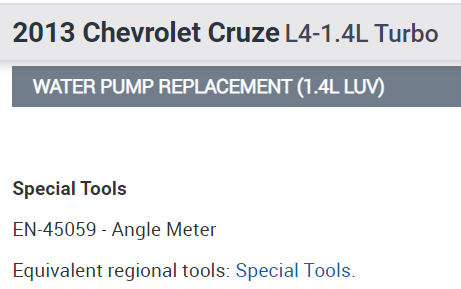

I've attached picture steps below on how to remove and replace the water pump for your car. As far as tightening sequence it just states to install and tighten in a cross sequence and torque to 71 lb in. Hope this helps and thanks for using 2CarPros. Happy Holidays.

Just remember lb in is a smaller scale than ft lbs. Let us know if you have any further questions on this issue. Thanks again for using 2CarPros and we hope you will use or site again in the future. Happy Holidays.
