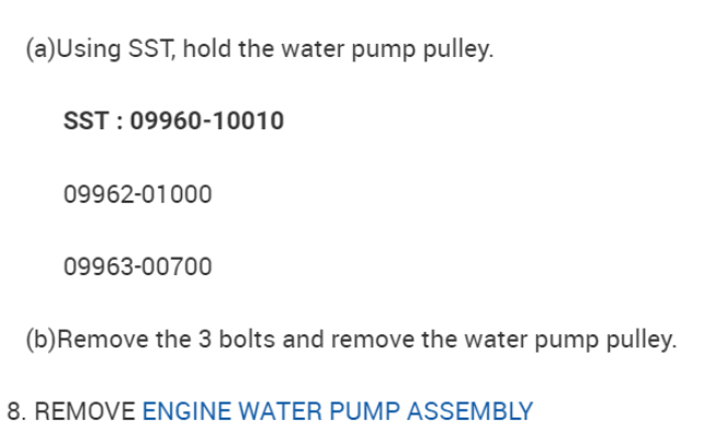

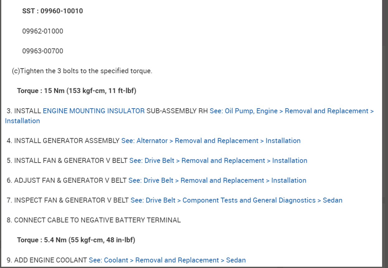

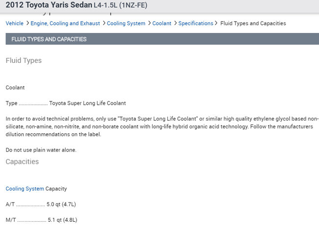

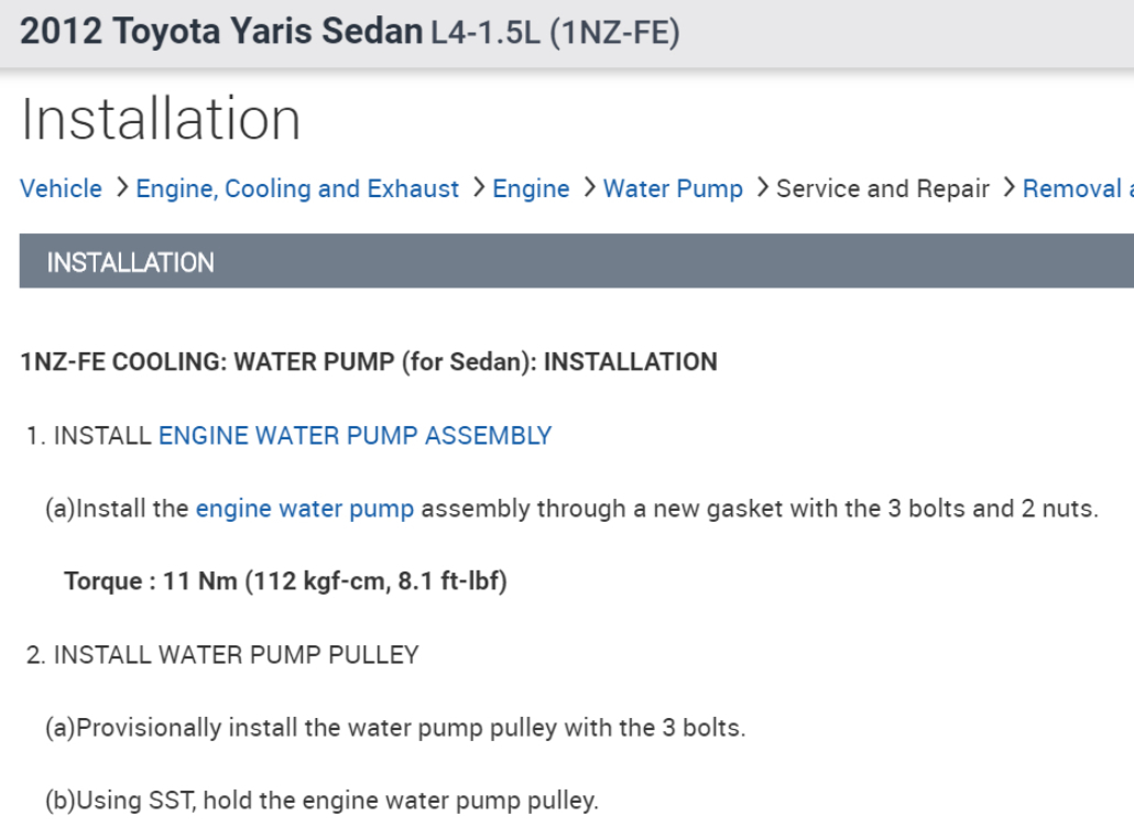

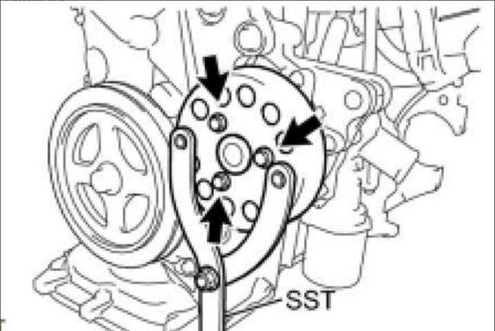

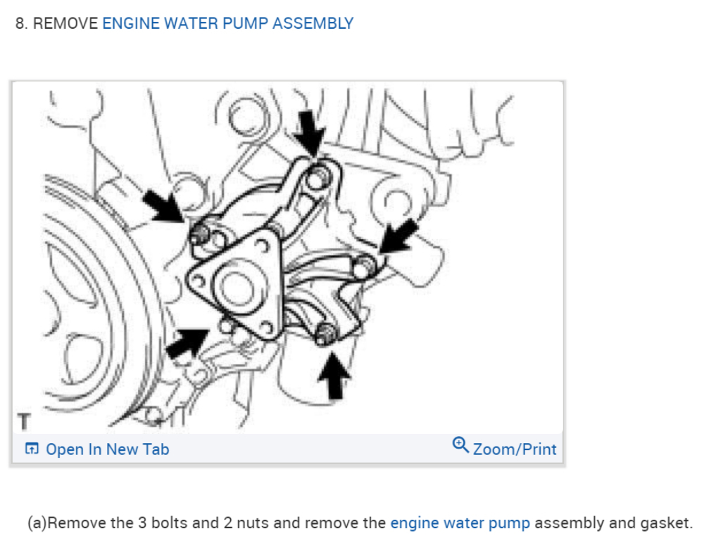

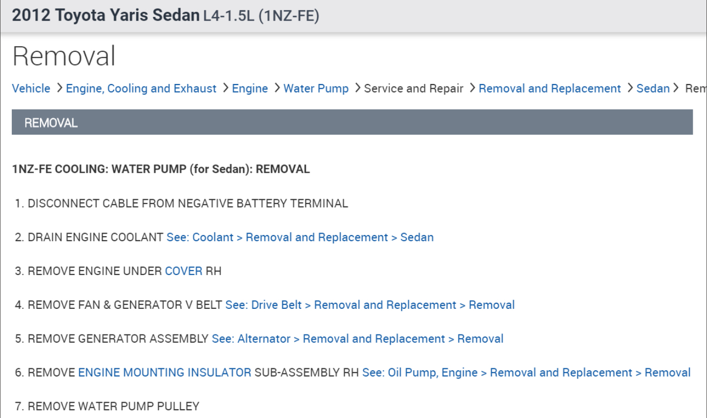

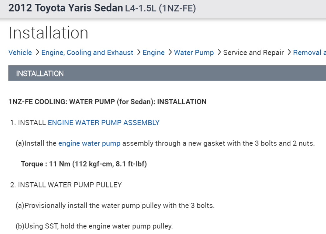

Hello again,
Down below in the diagrams I have posted the instructions for removal, as well as installation of your vehicles water pump, as well as the fluid recommendation and capacity.
Here is a guide that will walk you through he steps with direction and diagrams below for your car:
https://www.2carpros.com/articles/water-pump-replacement
