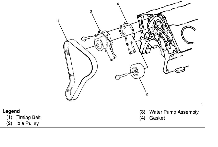

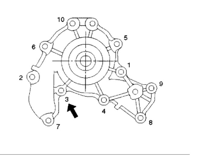

I have found some diagrams and a guide to give you an idea on what you are in for when doing the job.
You will need to disconnect the battery and drain the coolant to begin. You should jack the car up to make it easier to work on
Here is a generic water pump replacement guide.
https://www.2carpros.com/articles/water-pump-replacement
Timing belt and serpentine belt diagrams.
https://www.2carpros.com/diagrams/honda/passport/2001
