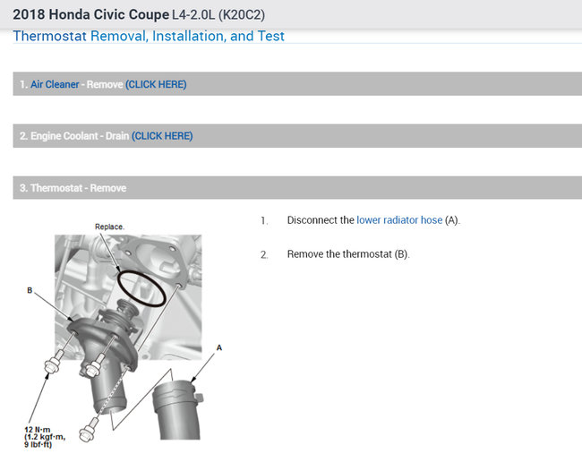

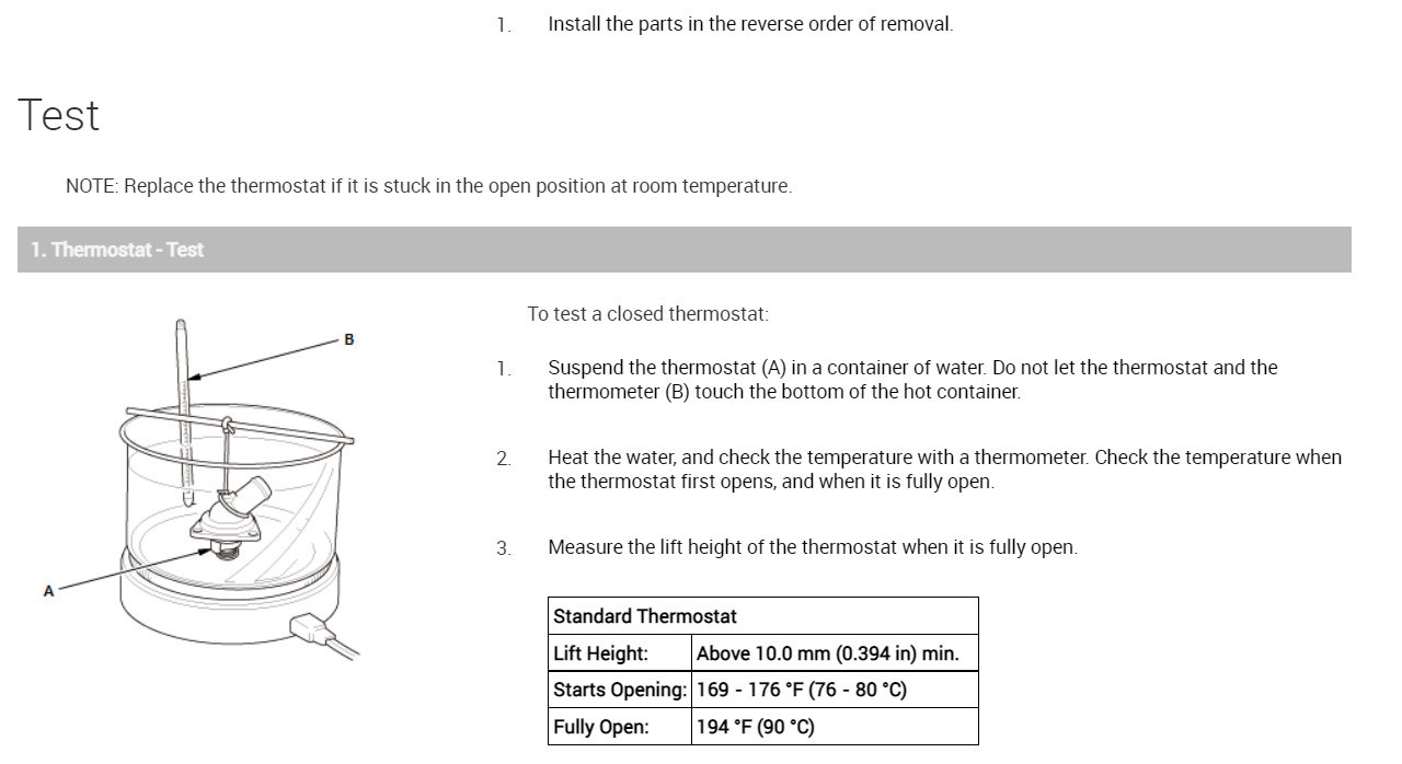

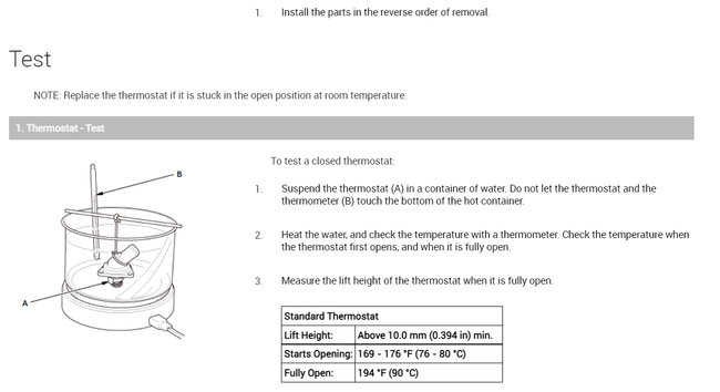

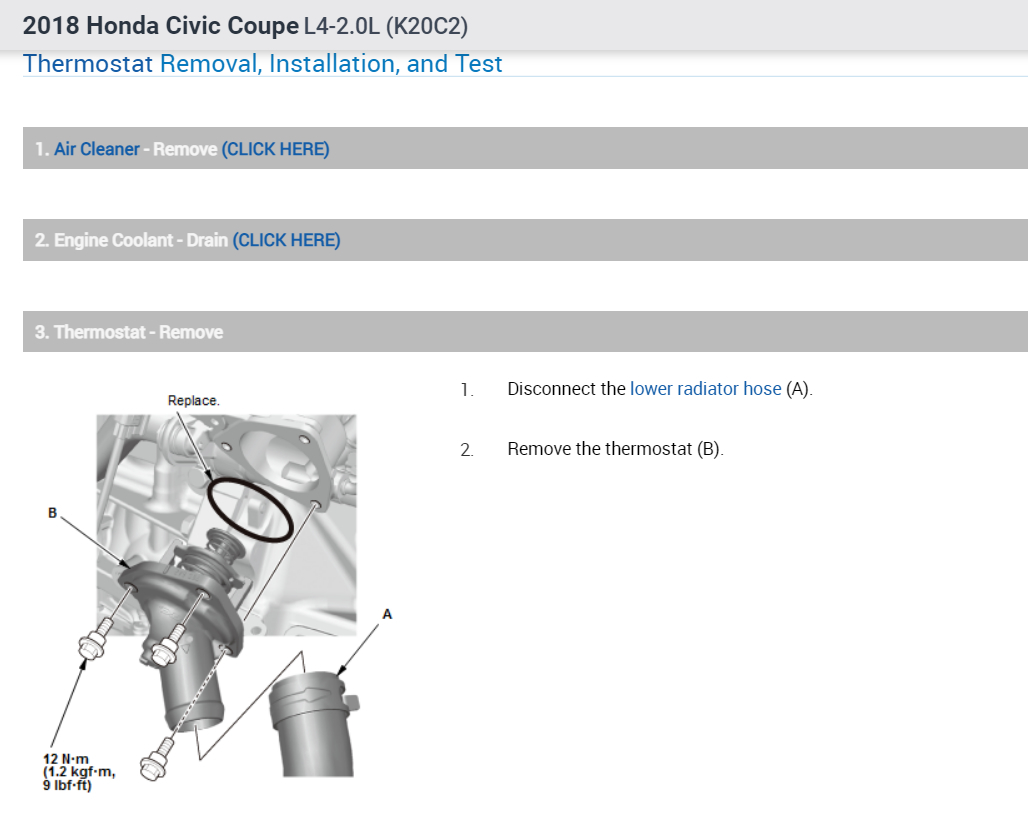

There are no special instructions on how to refill the system. How fast does it overheat? does it act like thermostat is stuck closed? With the engine cold I would remove the upper radiator hose and try to fill the system through the hose and directly into the radiator. If that does work here is how you can change the thermostat out in the images below. This guide can help as well:
