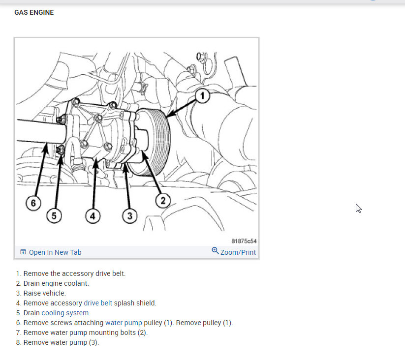

How do I replace the water pump?

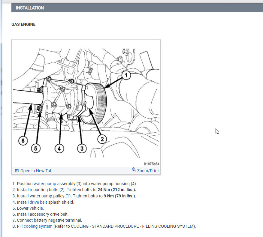

Attached is the process from the manual. Also, here is a guide that will help in more general terms.
Let us know if you need more info. Thanks
https://www.2carpros.com/articles/water-pump-replacement
