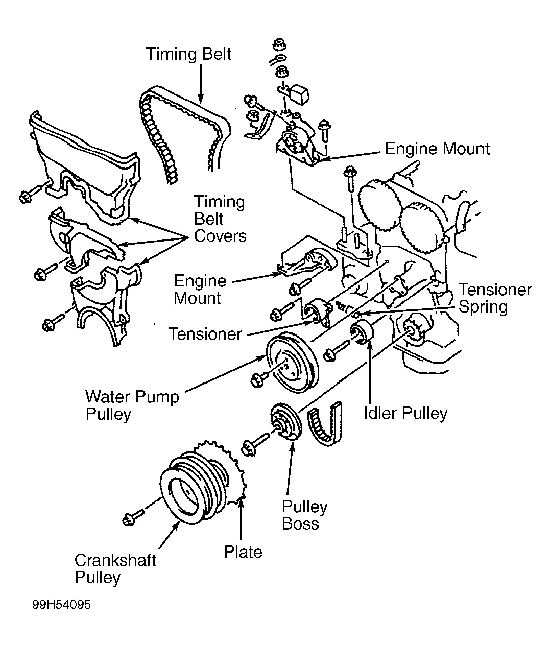

Is the pulley wheel itself actually detachable? I've received conflicting info from others on whether it's part of the pump or removable on its own.

OK, here is a diagram...

No problem... There should be as you can hopefully see in the pic 3 bolts holding it on.
