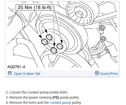

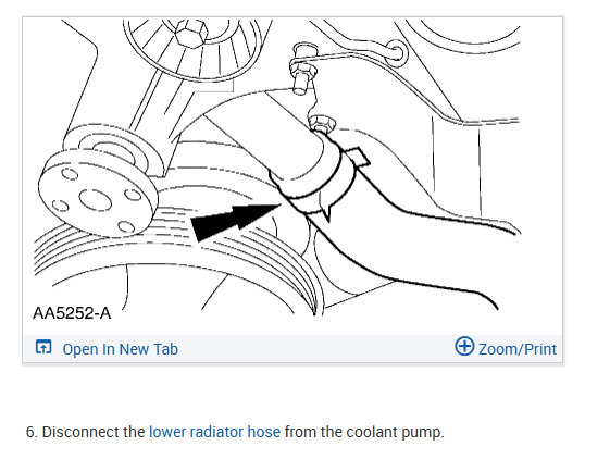

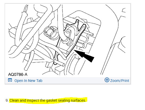

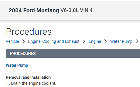

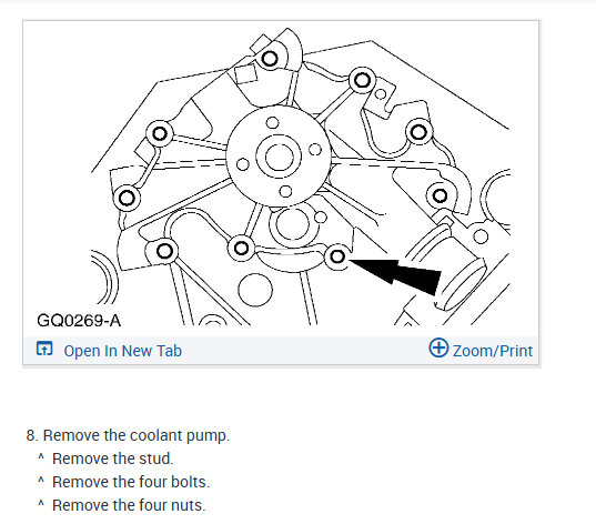

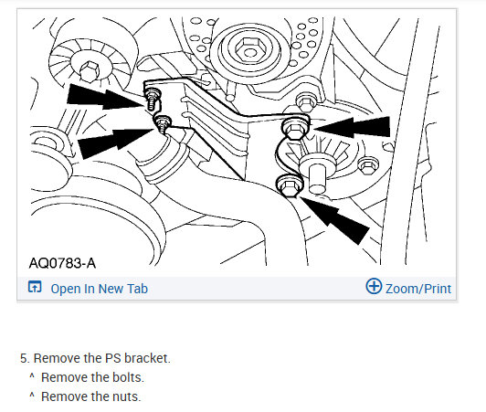

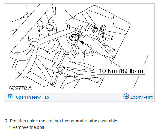

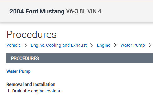

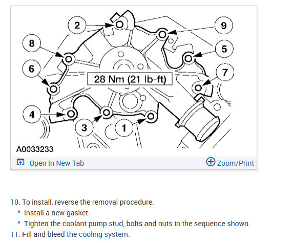

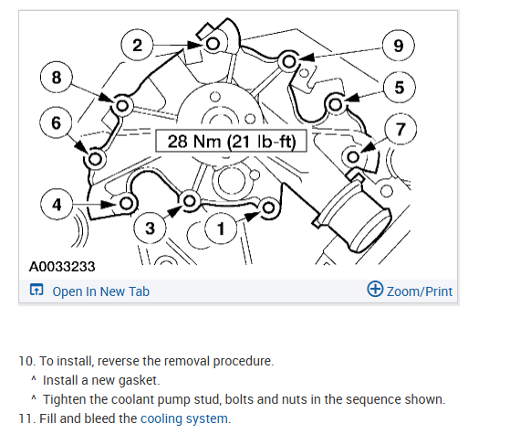

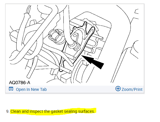

As far as what is needed is concerned, you will need a new pump, which should come with a new gasket. Additionally, you will need to drain the old coolant, so new coolant is needed as well.
This is a great time to replace the radiator hoses if needed. Inspect them to see if there is evidence of wear or damage.
To help, I attached the directions below for replacing one on this vehicle. Also, here is a link that you may also find helpful:
https://www.2carpros.com/articles/water-pump-replacement
Let me know if this helps.
See pics below.

Can you please give me a part number on the coolant heater outlet tube? please
Apr 12, 2025 at 12:57 PM
Sure, here is he part number - 1R3Z-18B402-AA
