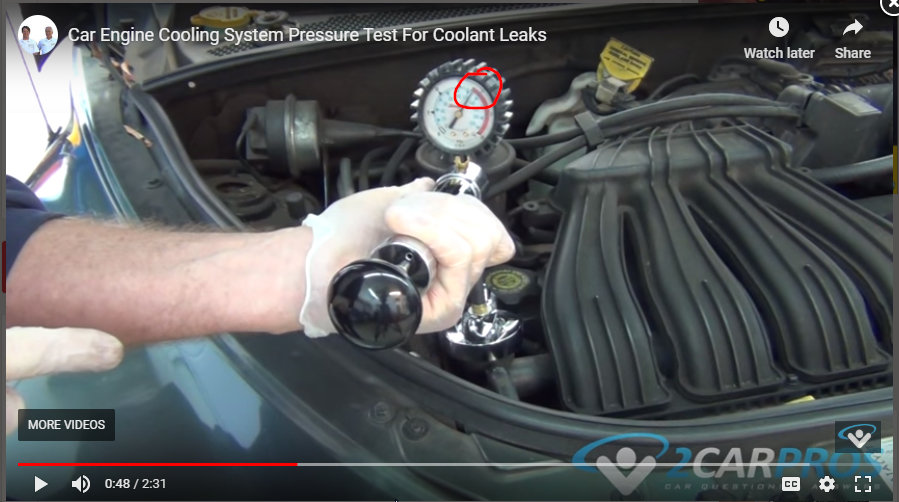

So this may take some convincing but I would watch this video so you are familiar with how to test the system and then ask to be shown how it was tested. Don't tell them on the phone that is what you want because that will give them time to prepare. Just tell them you want to come down and go over the vehicle so you are clear on what needs to be done. While going over it, ask them to show you how they tested it and found the leak so you can see the leak as well.
If the leak is coming from the front of the water pump then this is the seal and is the weakest link in the system after the pressure relief on the cap. The cap is designed to allow small amounts of pressure out so that the system does not over pressurize and leak. However, when they test it the cap is not on there and if they add too much pressure the front pump seal is the first to allow the pressure out. Once it fails it leaks.
Just make sure they are using a cooling system tester and ask what PSI they tested the system at. As you can see if they are using the proper tool, it is almost fool proof because there is a big red line on the gauge telling them it is too much pressure.
https://youtu.be/W8kra65m15c
